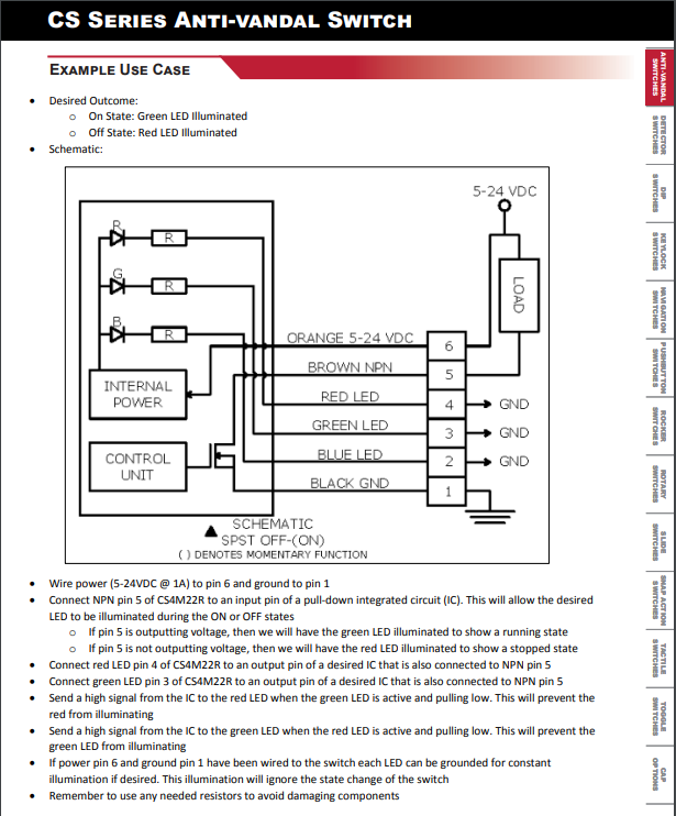

I am doing quite a lot of heavy modifications to my PC case, and I am stuck on an issue involving a Capacitive Anti-Vandal Momentary switch (CS4M2FR information) as I have next to no electronic experience. I want to wire the switch in parallel to the current switch so that I can use it as an alternative switch located on the top of the case which is an easier to reach location then behind the lockable front panel door.
Through trial and error I have worked out I need to connect the ground (Black) to the negative pin for the power switch, the NPN (Brown) to the positive pin for the power switch and the 5-24VDC to the positive pin for the reset switch. On page 4 linked here of the switch data sheet. It details an example use case that is directly applicable to what I require however my limited electrical knowledge means I can’t decipher it.

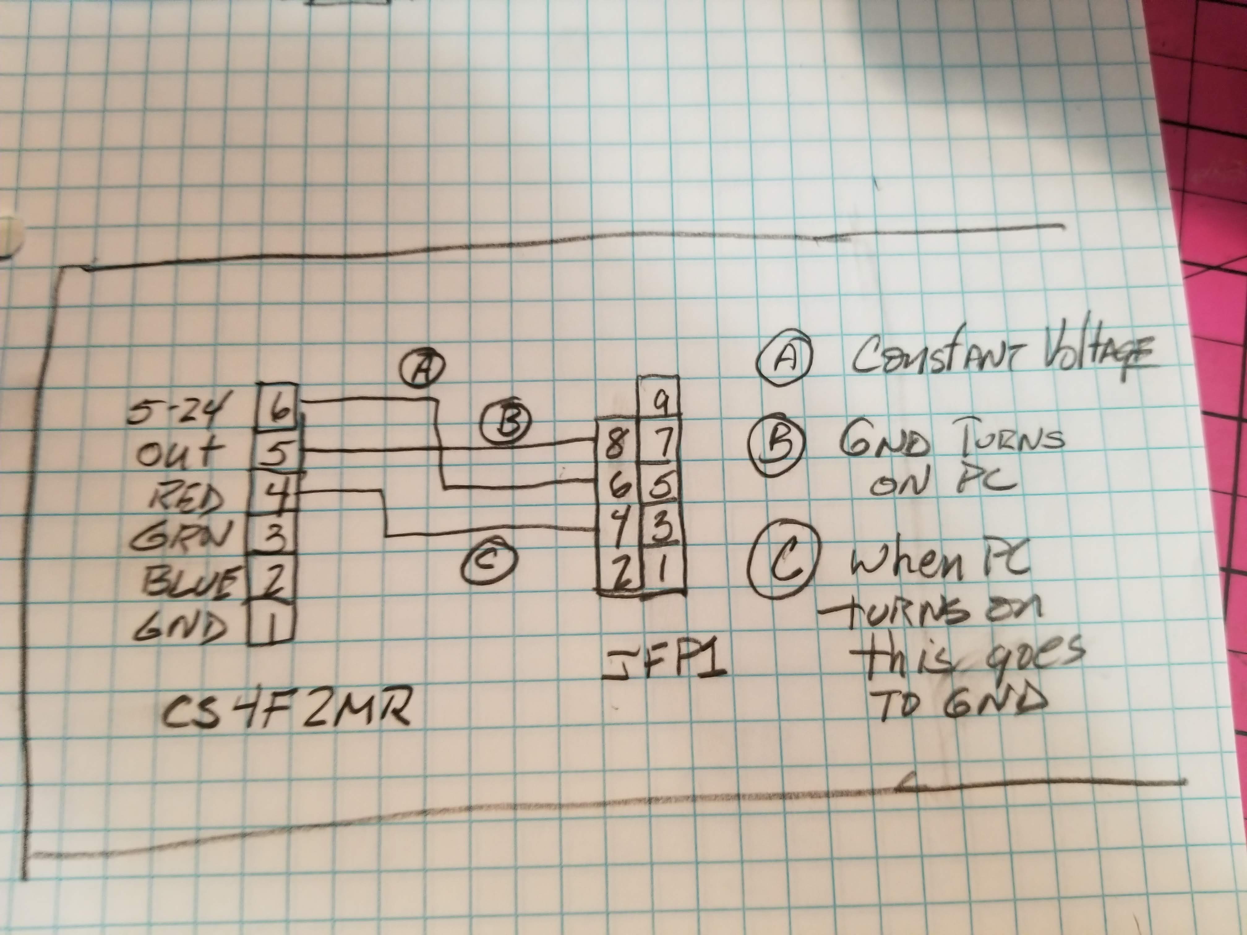

I don’t quite understand what you want the switch to do or how it is connected into your PC but here is my thinking?
Here is the schematic of the switch you provided:
As I understand the switches interface:
Pin 6: power 5-24V
Pin 5: switches when the button is pushed and grounds pin 5 [turning on load]
Pin 4: when grounded turns on Red led
Pin 3: when grounded turns on Green led
Pin 3: when grounded turns on Blue led
Pin 1: connect to ground [other side of power on pin 6
The application instructions are a bit vague but I assume this switch is intended to:
  • Switch a load on pin 5 when the button is pushed.
  • A processor watches pin 5’s state and then turns on one or more of the led’s by grounding their associated pins.
If I ground one of the colour led wires against a metal panel then that corresponding led lights up constantly regardless of whether the switch is in an off or on state. [I would expect it to work this way assuming Pin 1 connected to the metal panel and the - side of the power supply is connected to the metal panel]
If I connect a colour led wire to the negative pin for the power LED then it lights when the system is off and turns off when the system is on (the reverse of what I want). [by power LED do you mean the CS4F2MR? What is pin 1 connected to in this situation]

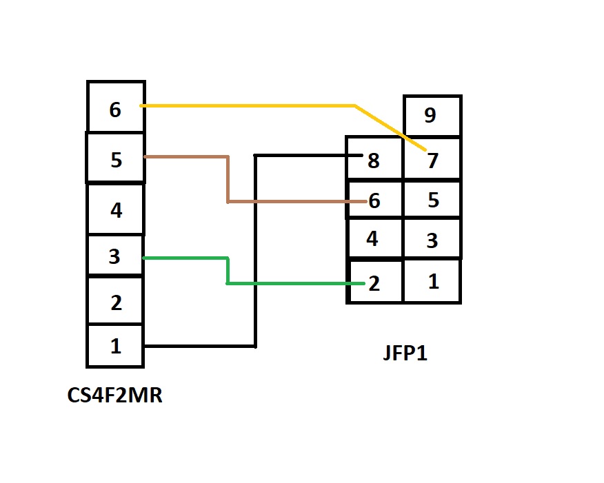

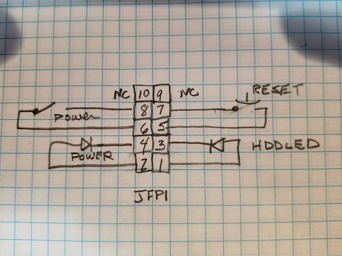

The below drawing is how I would to guess how to hook it up to JFP1.
However not knowing what is on JFP1 you could damage the PC inputs/outputs if I did not guess right.
Use at your own risk …
I would first test JFP1 to see how it operates without the new switch installed.
  • Is pin 6 a constant DC voltage? What voltage?
  • Does pin 8 go to ground when the current power button is pushed?
  • Does pin 4 go to ground when the current power led come on?

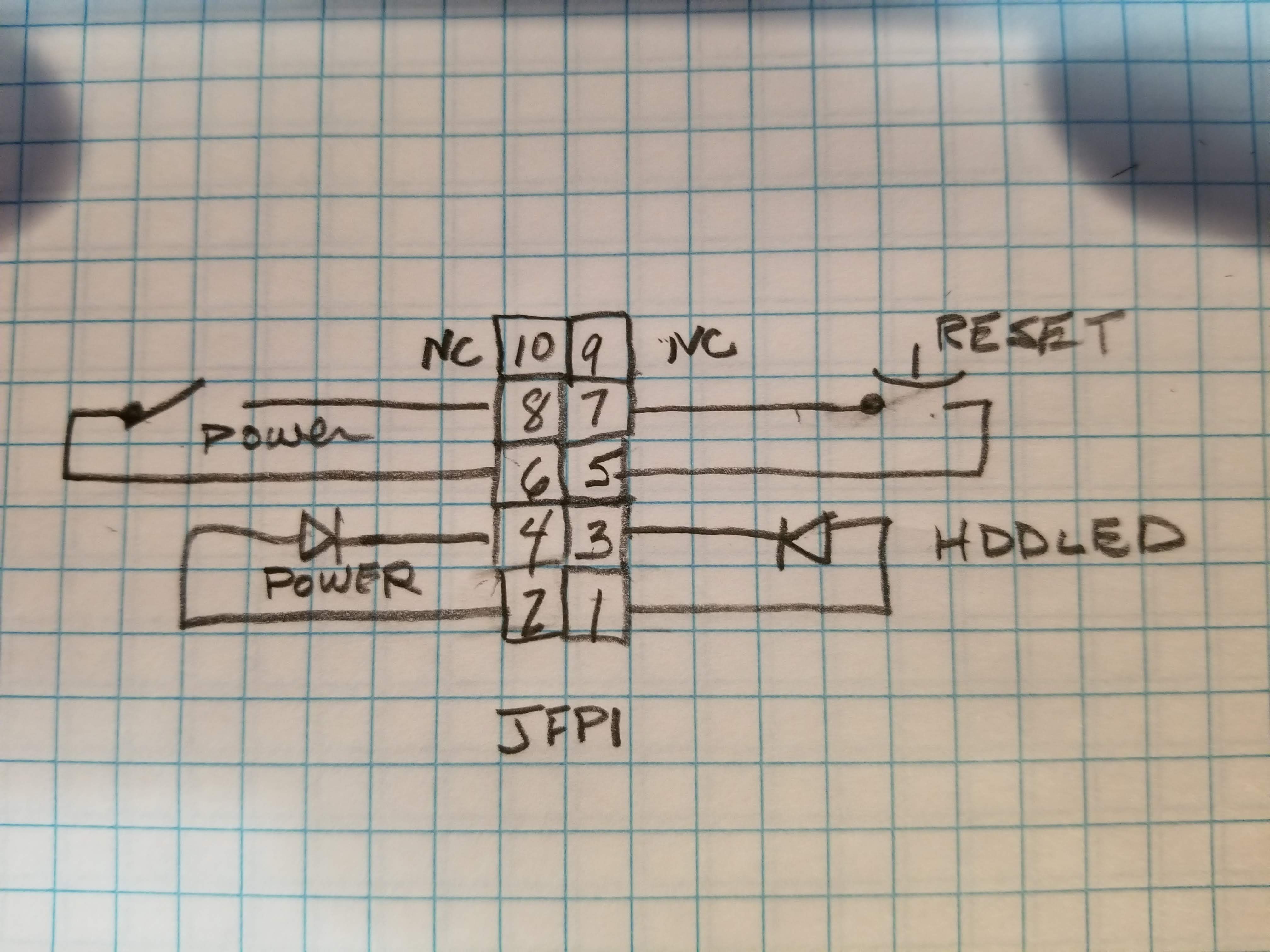

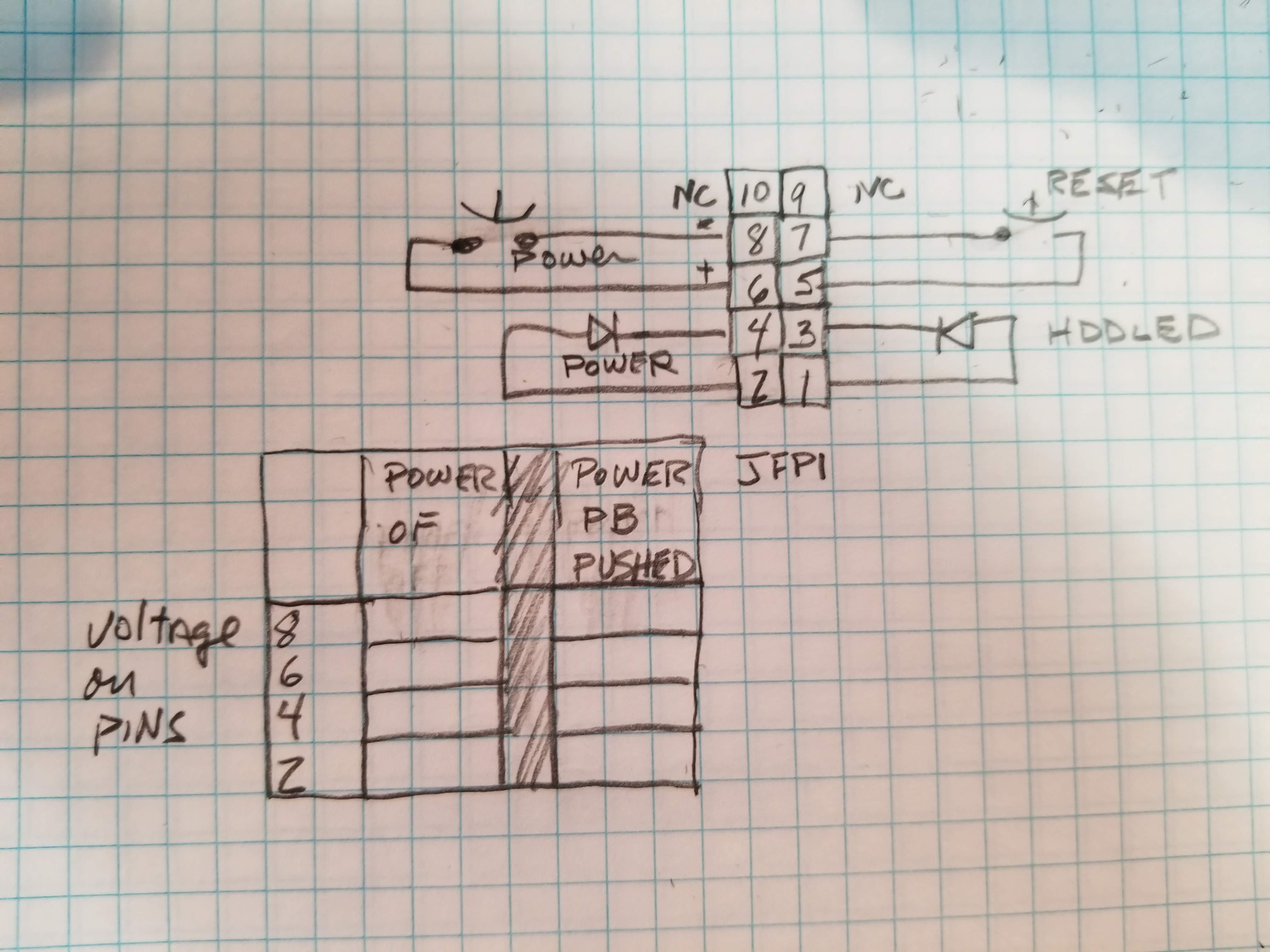

Can you verify that the current wiring is like this?
You may have to trace the wires.
Change the drawing as needed.
From this drawing we can do some measurements and confirm how the pins behave.
Is the current button a CS4F2MR?
Do you have access to schematics for the motherboard?

Can you fill in this table by measuring each pin with a DVM?

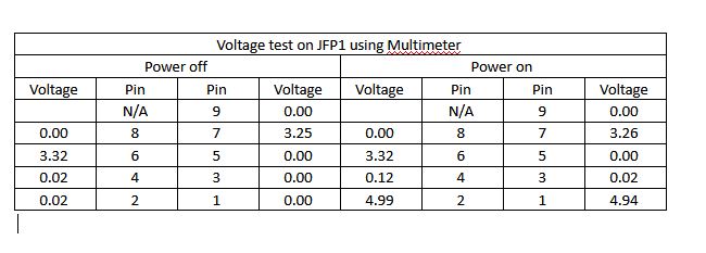

Capture
Measurements taken with negative side of multimeter attached to the PC case frame as ground and the positive side used to measure. Did you want me to measure with the momentary switch on pins 6 and 8 held down?

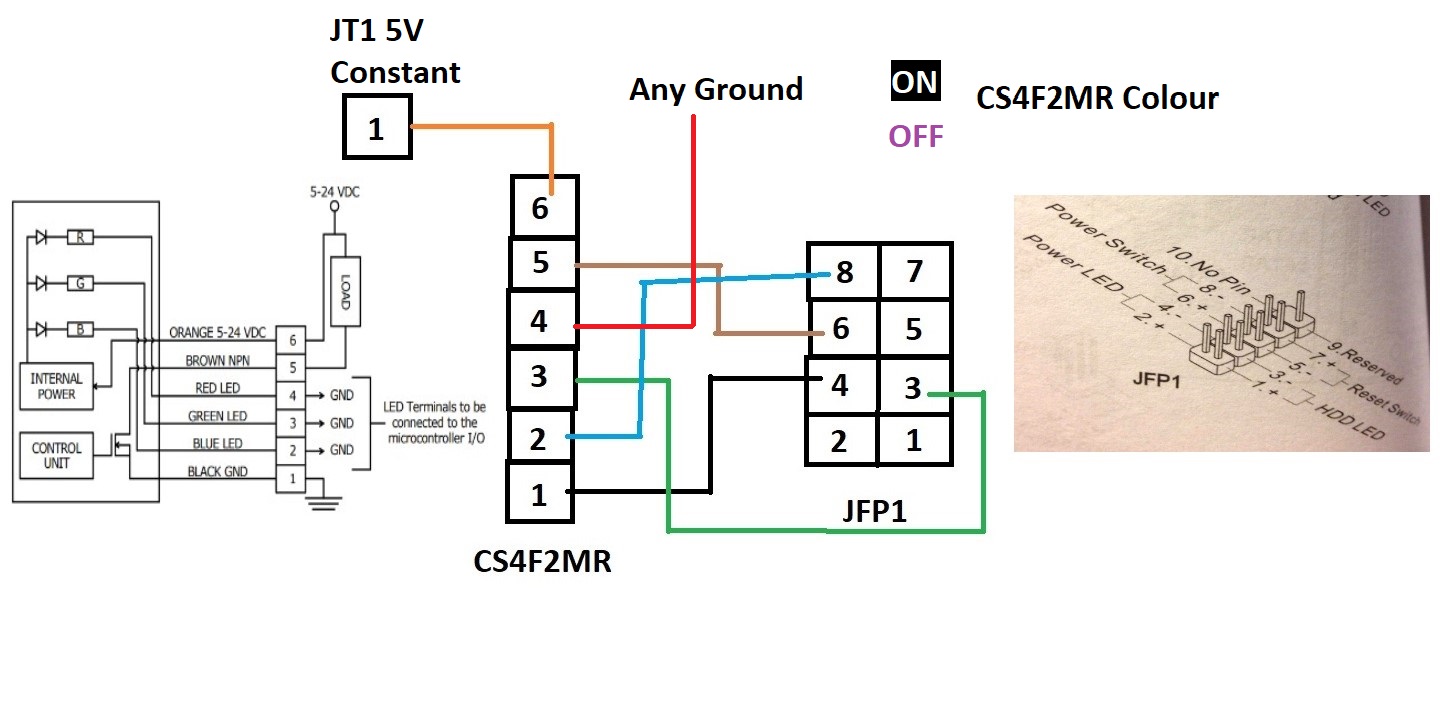

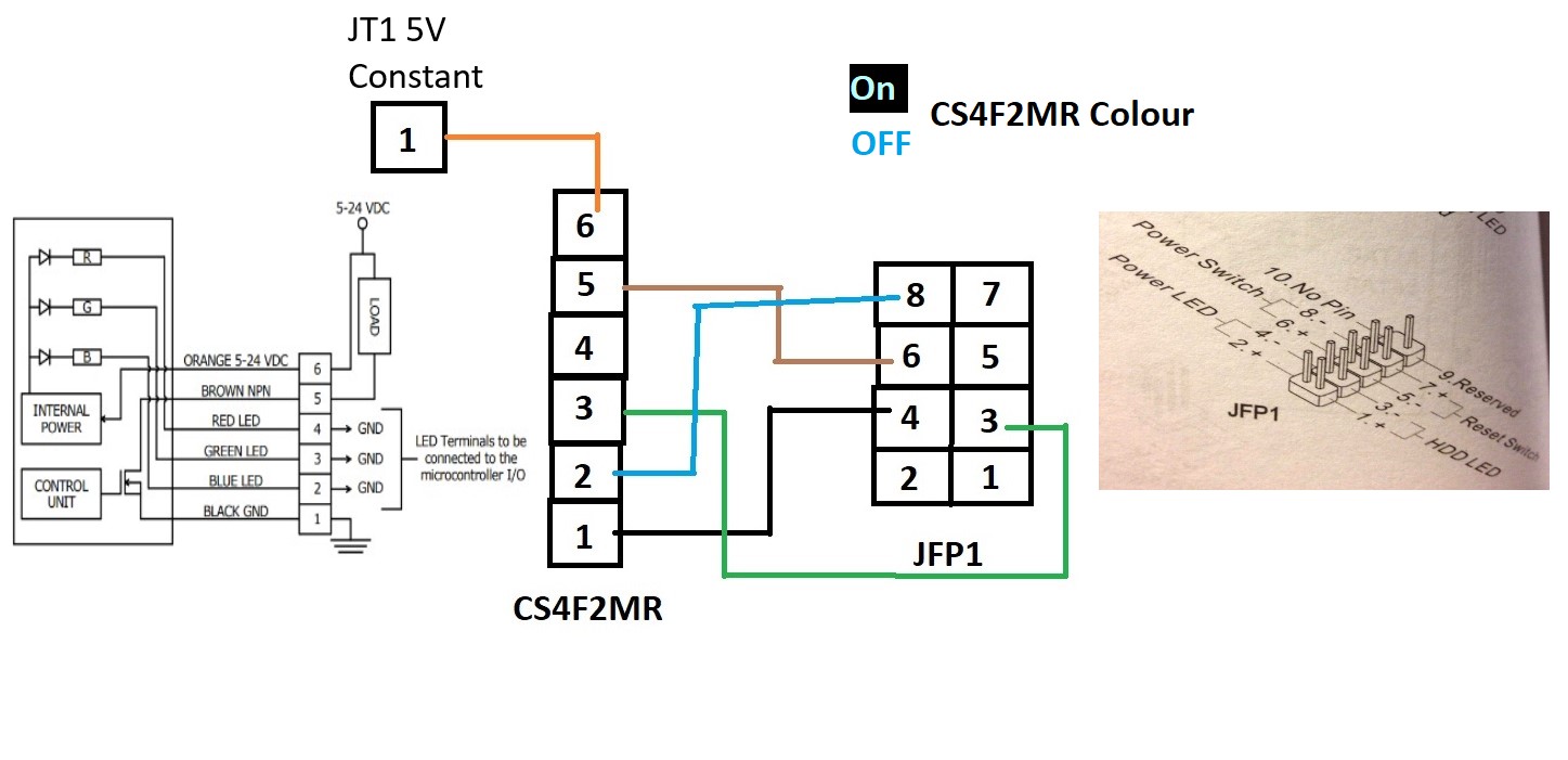

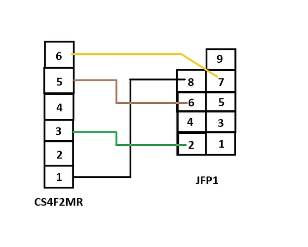

Thank you, Don for the probing questions and help by drawing out the pin maps and circuits logically. I am so close now but it is still not 100% right. The image below result is the result of some trial and error. I realized the Orange wire (6) from the CS4F2MR needed a constant positive of at least 5V to function. So I checked all available pins on the board and found JT1 (not listed in the manual) gave 5V when the PC was both on or off. The NPN Brown wire (5) was the switching part of the connection and the Black wire (1) needed constant ground to allow the switch to function as expected switching the PC power on and off. I then tried connecting it up as below:
When the PC is off the CS4F2MR is a bright blue colour and when the PC is on the CS4F2MR is a bright teal colour (Green and Blue combined lacking Red).
I am now stuck trying to figure out the correct placement for the connection of the red LED wire. If I connect the red LED to ground on any point I get purple on the CS4F2MR when the PC is off and white when the PC is on.
So this is the final circuit map and the CS4F2MR appears to work exactly as intended. Now I just need to test it in parallel with the current switch.
