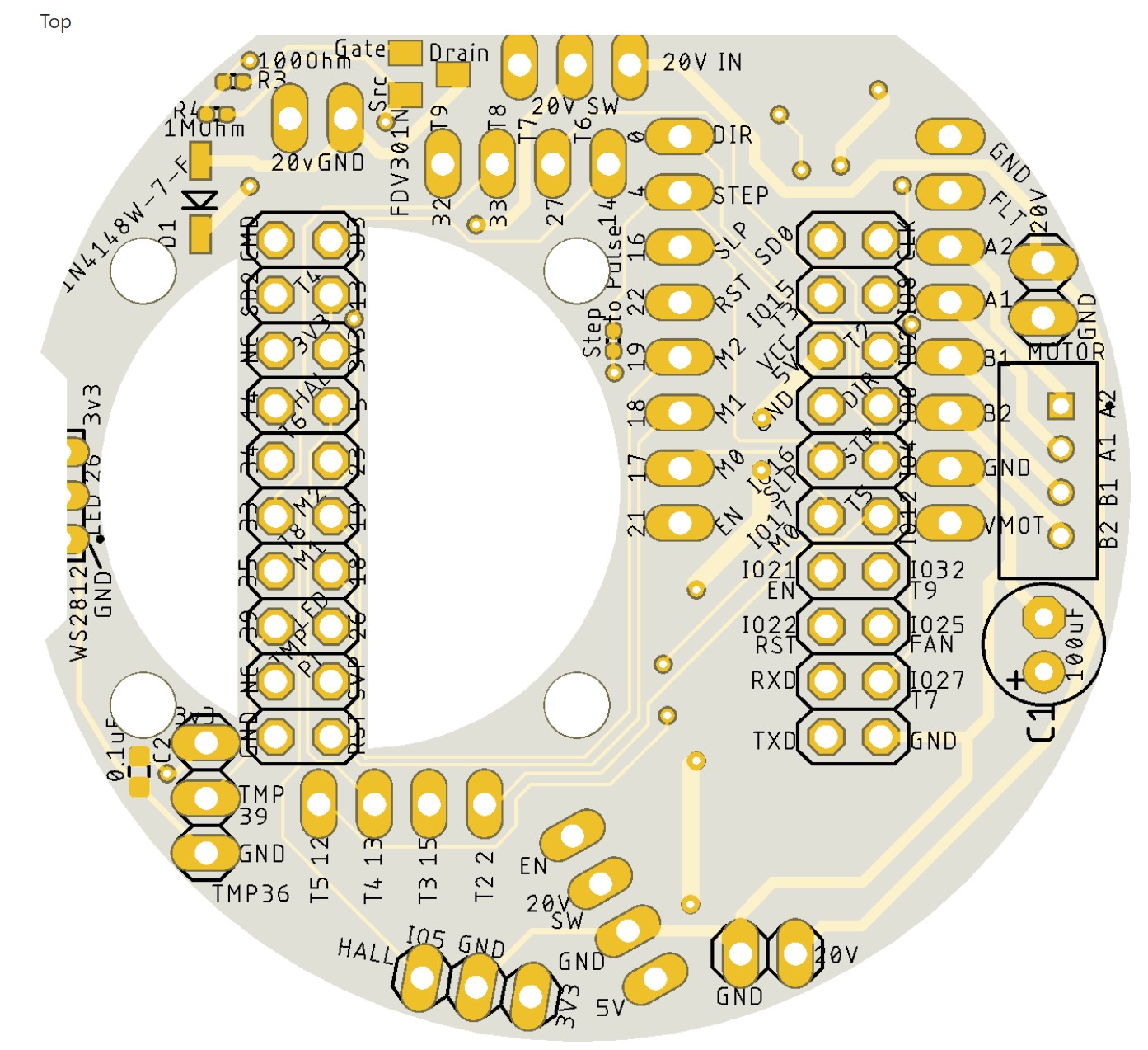

Ordered the Actuator PCB Circle from JLC, using the zip file on GitHub.
JLC responded back that they could not produce the board because of 1/2 holes outside of board.
Looks like they are referring to (3) 1/2 holes at the ws2812 ?
Is there new file out there or can anyone suggest the correct fix? I have eagle so I suppose I should be able to revise board.

That is weird, i got mine from them. I did use a modified version of the file, but all that did was change the resistors to a larger 0603, and put almost everything smt on onside to make them easier to assemble on a hotplate. The half size holes for the led were not changed, and came out fine.

Yeah, they made mine without a problem either. I did design it to have those holes end up castellated. Maybe they’re getting stricter with not letting you do that. It could be redesigned with square pads there, you just end up with a bit less surface area to solder to for that ws2812 at a right angle.

Figured it out, I did not have castellated holes checked yes on JLC.

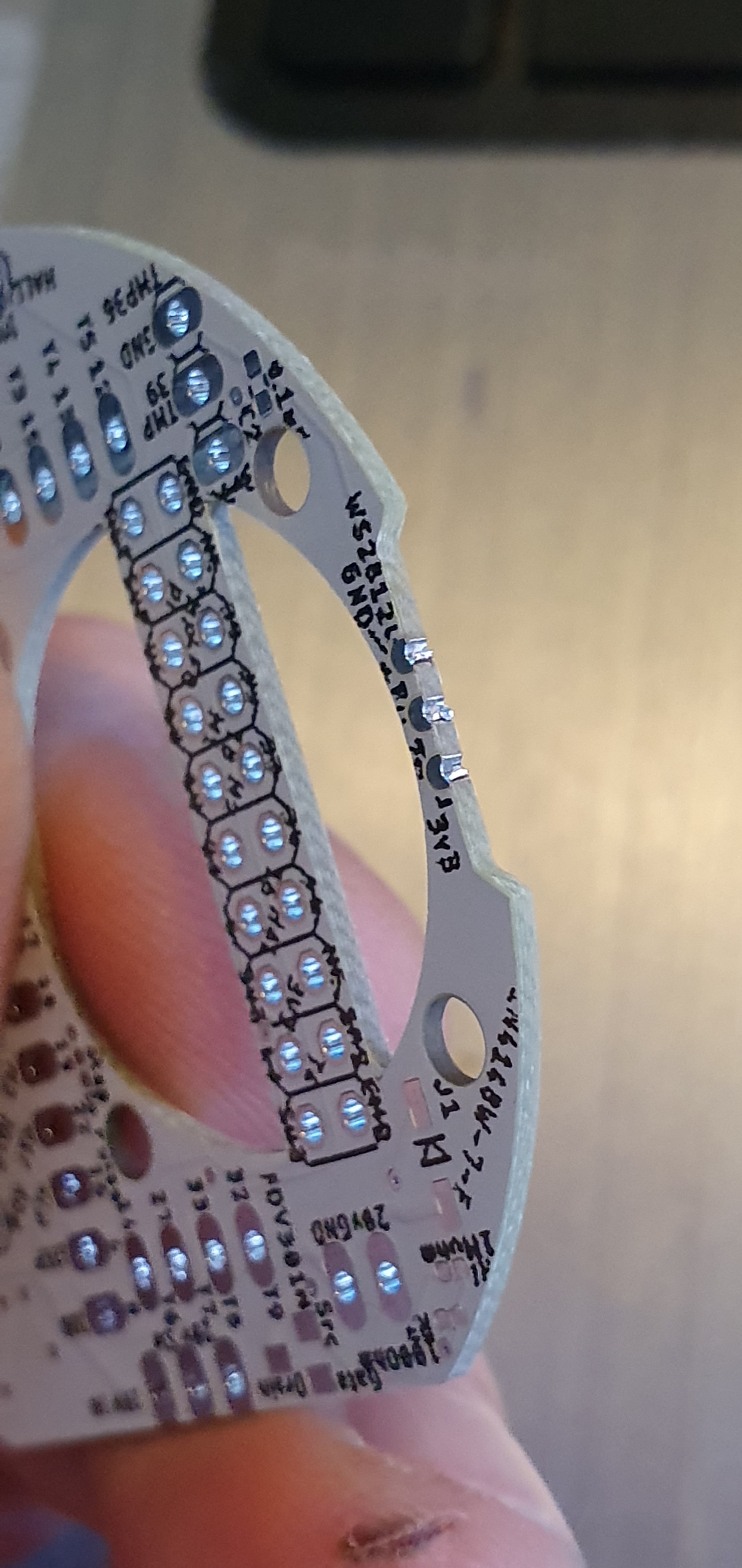

We just ordered a batch of these and left castleated holes unchecked. Jlcpcb sent back asking if we wanted castleated holes. We responded “no, just run them as is” and they came back fine. There is some extra processing and an extra charge for castlelated holes that we didn’t think was necessary.
Also ordered 20 pcb at JLCPCB and got the question, I responded that it doesn’t need to be castellated and got the pcb with no poblem.
This is the first time I ordered pcb’s and wow! 20 pcb for 10 dollar and I got them in 7 days!!!
Here is a picture of the 3, not castellated, hole’s:
