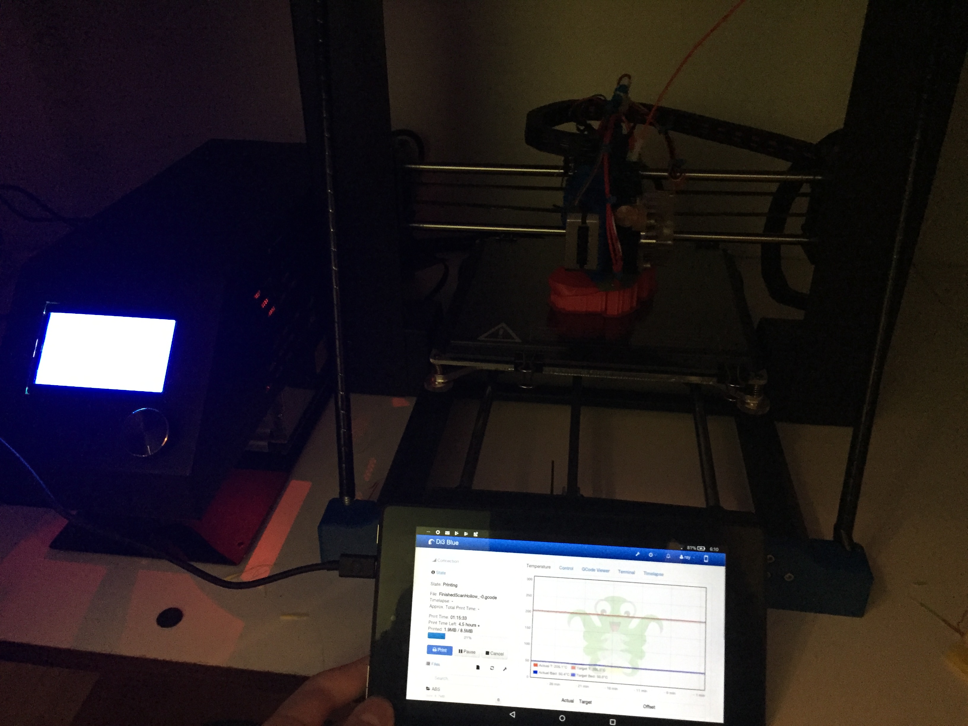

Per a Reddit post, I ordered a $29.99 Fire 7 tablet to act as a screen for Octoprint.
Will see what happens.

Same tablet used a long ago to drive LaserWeb

I got 2, works well for me running the duet online system controls. Best 30, iv ever spent. You’ll really hate all the amazon adds though, that’s for sure…
