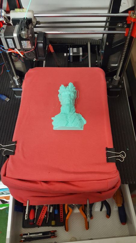

Personalizing t-shirts with filaflex, this week I’m going to make super nerd t-shirts :slight_smile:
Originally shared by Miguel Angel Salmeron
I´m Groot :slight_smile:
La impresión ha sido buena y esta muy bien fijado a la camiseta pero me ha pasado un poco con el relieve.
He comprado un par de camisetas más y me lo voy a pasar pipa :slight_smile:
Let us know how long it takes to delaminate from the shirt
Hello sir
this is simply great! What kind of fabric is the shirt made of? What temparature did you use for the first layer?
@Alex_Krause ,the first wash I take it well :), i leave some images http://imgur.com/a/k7HqK.
@Reinhard_Barmonster , it’s a cotton t-shirt. The first layer put more temperature than normal so it sticks well.
240º the first layer and all the others to 220º to about 30 mm / s.
