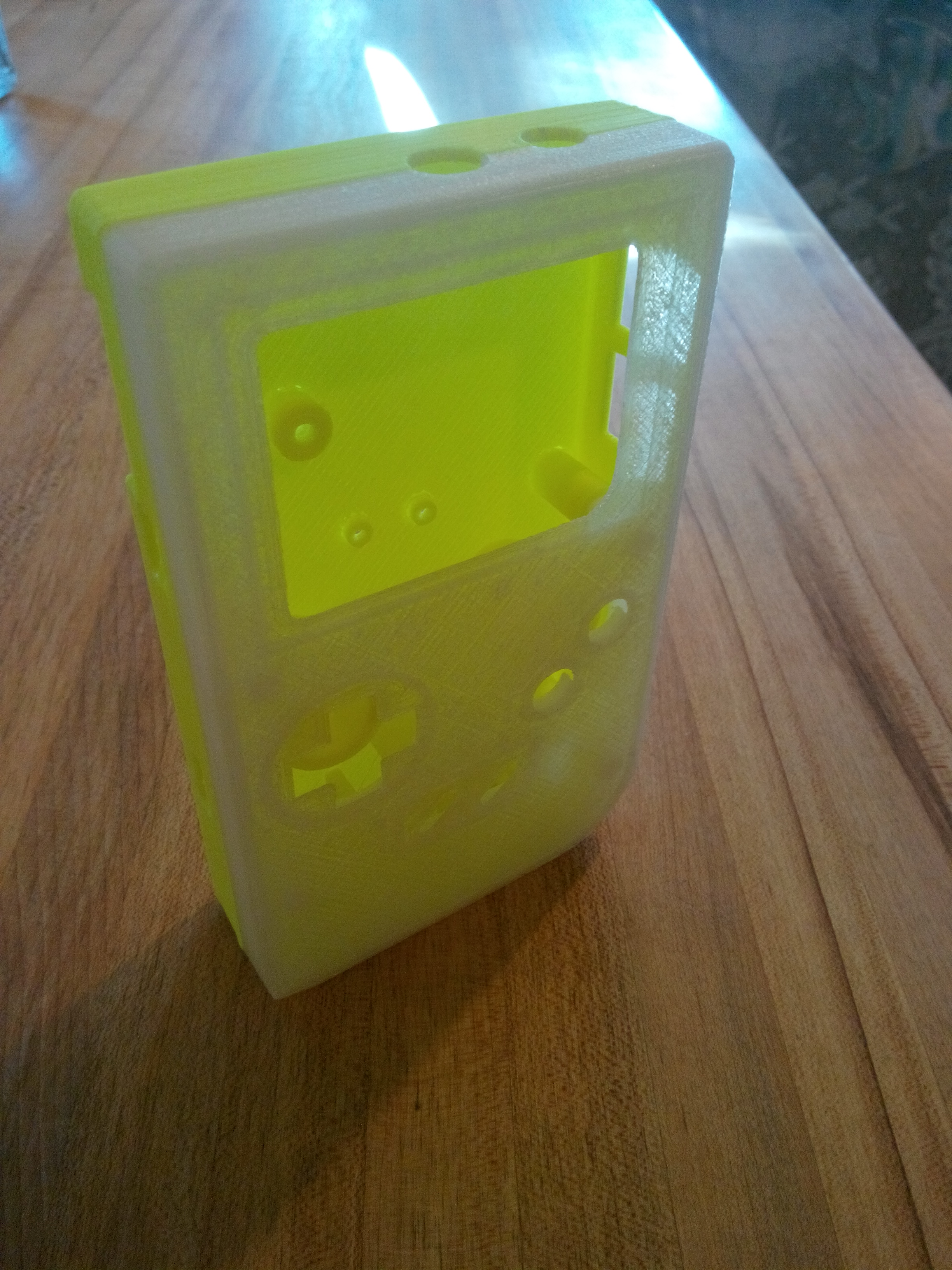

Done! Now i just need the rest of the parts, the top came out really good no warping but i pinched the print by adding to much adhesive to the bed. No big deal. (why it may look funny, infill wise)
I was dumb when cleaning it i went to brush off some debris and it flew onto the concrete… still good just a small nick.
Looking good. Nice project.
Looks good, what layer size, nozzle etc
@Peter_L layer .2, nozzel .4, temp 235, bed temp 70 (need thicker cables) 10% infill (should have done 20%), speed … slow.
my i2 is set to around 45mm/s any faster and it starts skipping halfway through a print.
I printed it in ABS they suggest PLA im assuming because the perimiters will be stronger for the slot style (snap together) case. Acidently droped the case and busted a small piece of the lip on the bottom. PLA is a little harder to break.
