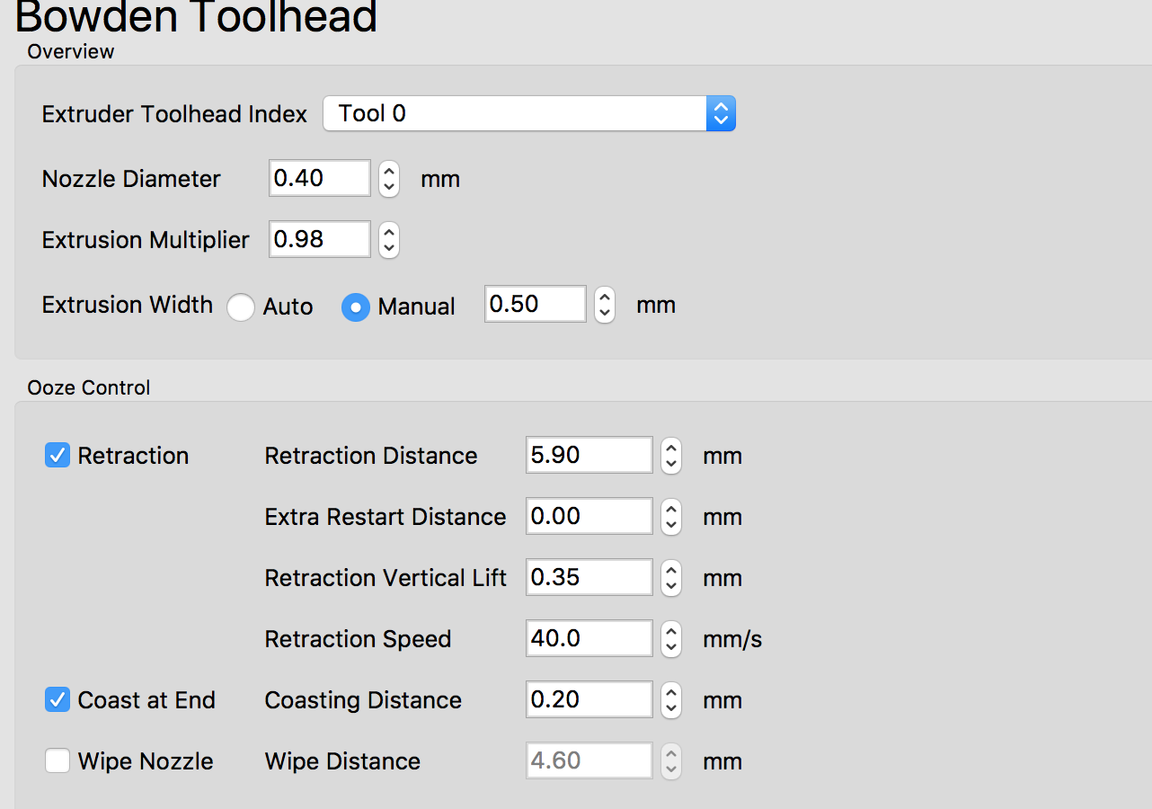

PETG? I cant get it to print well, what are your tips?
Bondtech, E3D V6
60mm/s print speed
tried both 40 and 60mm/s retract. 60mm/s worked best.
Bondtech, E3D V6
60mm/s print speed

@Zane_Baird thank you! I will try, you are using firmware retract then right?
@Stefano_Pagani Negative on the firmware retract. I just set independent acceleration for the extruder motor and don’t use “wipe while retracting”. Since there is no other movement during the retraction the extruder motor accel is not limited by any other accel values
Thanks for the help! Turns out my extruder was stalling on un-retract. Beefed it up to a 70mm
