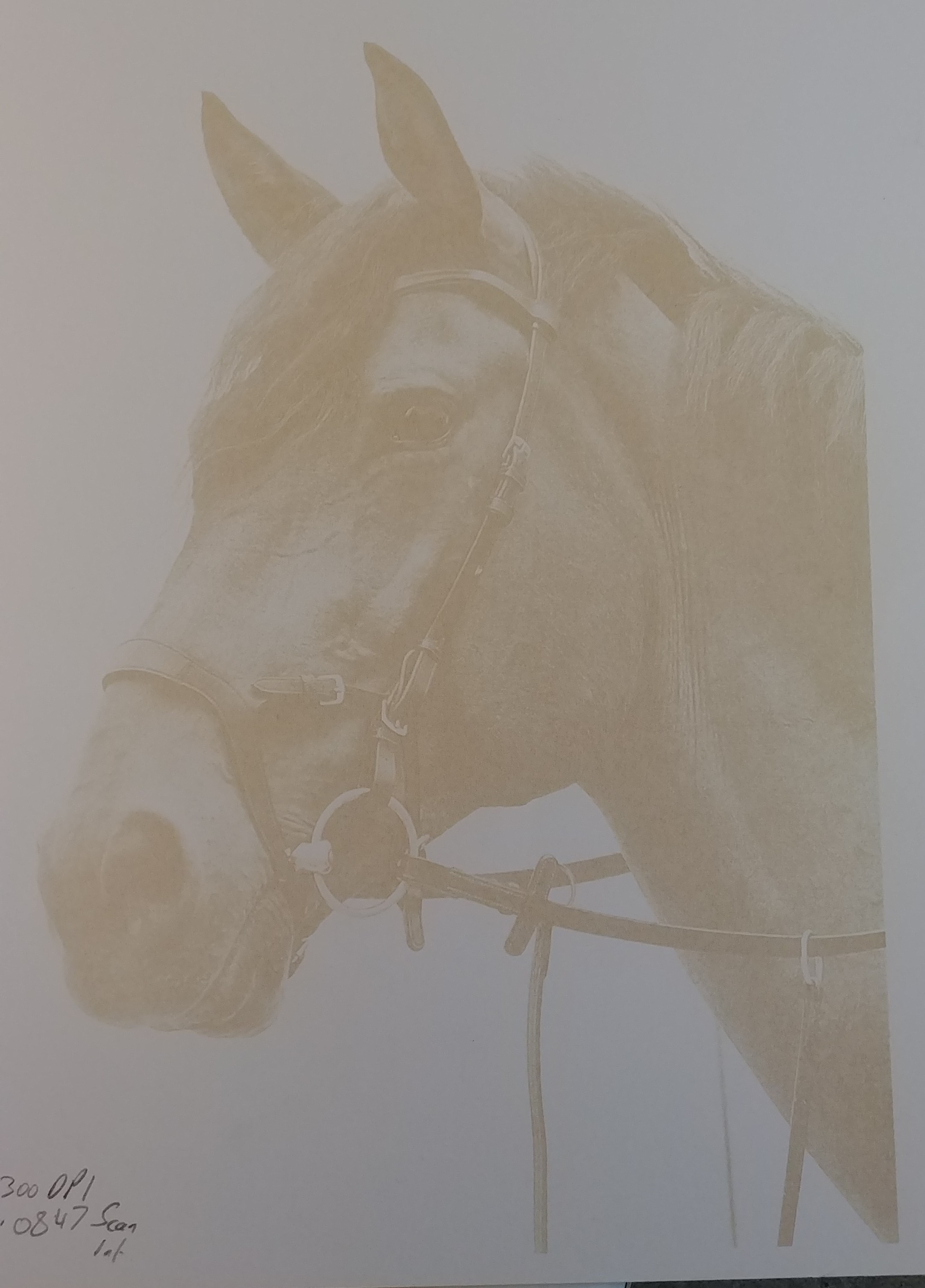

Been trying out some photo engraving, just on cardstock and some cheap plywood.
You might recognise the horse image.
Small engraving on plywood
Mdf and cardstock
Lookin good.
When you post this kind of content please let users know your settings :slight_smile:

Settings are still being finalised…
Speed is either 2-300mm and power is usually around 12-16%
K50

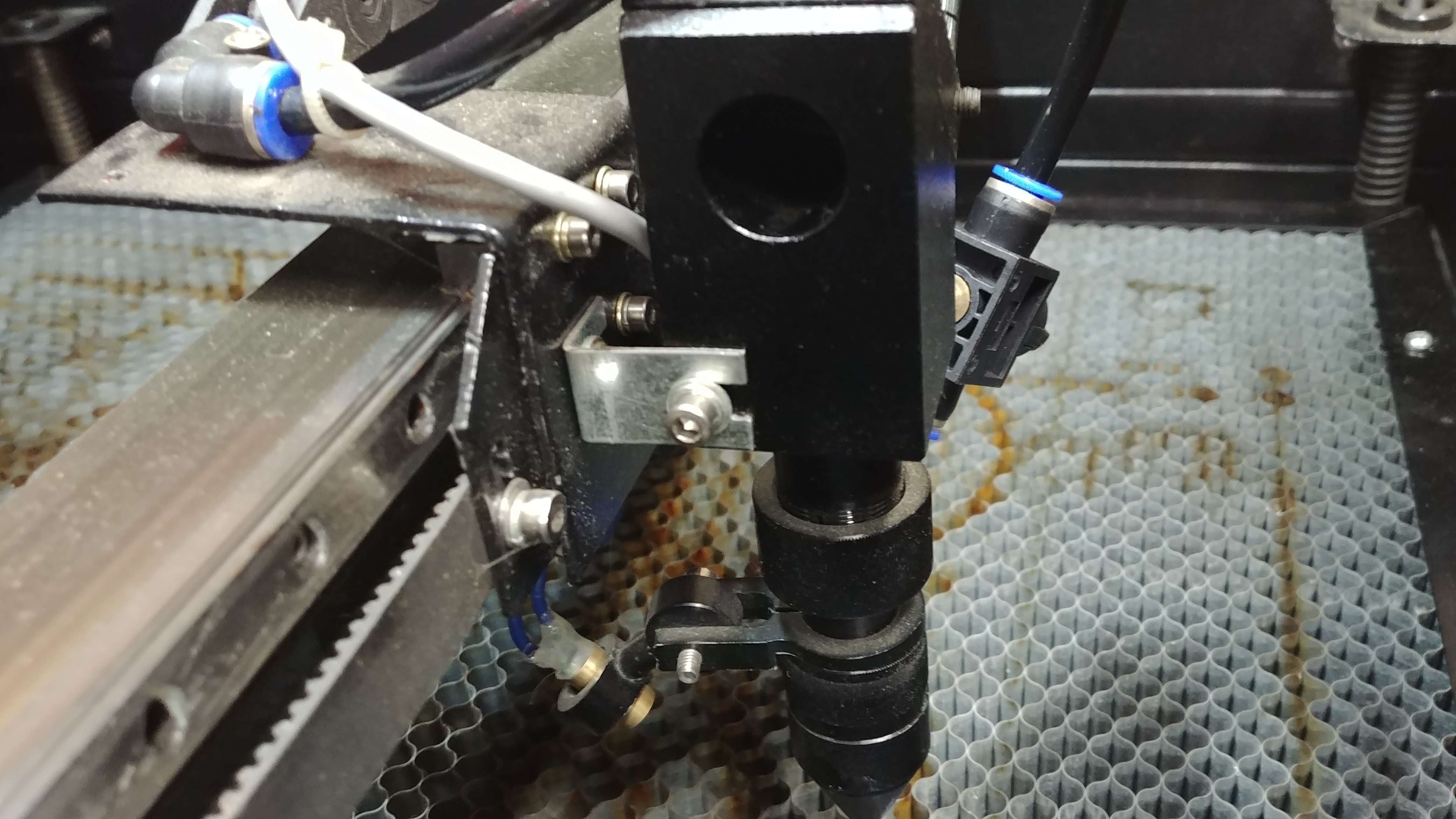

Can you post a picture of your head?
There it is with compound nozzle on it. I can take any dimensions you want to check from it.
Ya that head is a lot larger than that of a K40…
