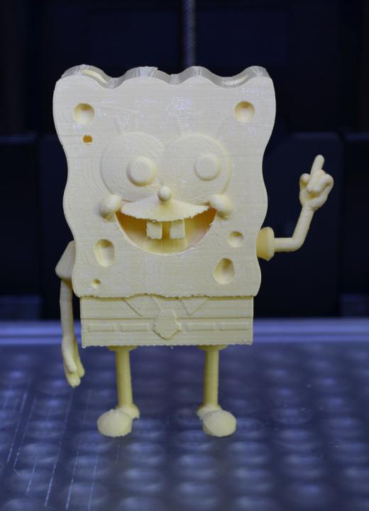

Photos during 3D printing SpongeBob. The final product is painted using enamel paint.
Photos during 3D printing SpongeBob. The final product is painted using enamel paint. Short “step by step” article is here:
Looks good, but it might have been better to print him on his back.
@Wylie_Hilliard
Yes, you are right. Less support in that case. Thank you!
@Dape_Part
The contours around the outside will also be smoother with almost no cleanup and the face will be flatter and have a better finish.
@Wylie_Hilliard
Thank you for great advice!
