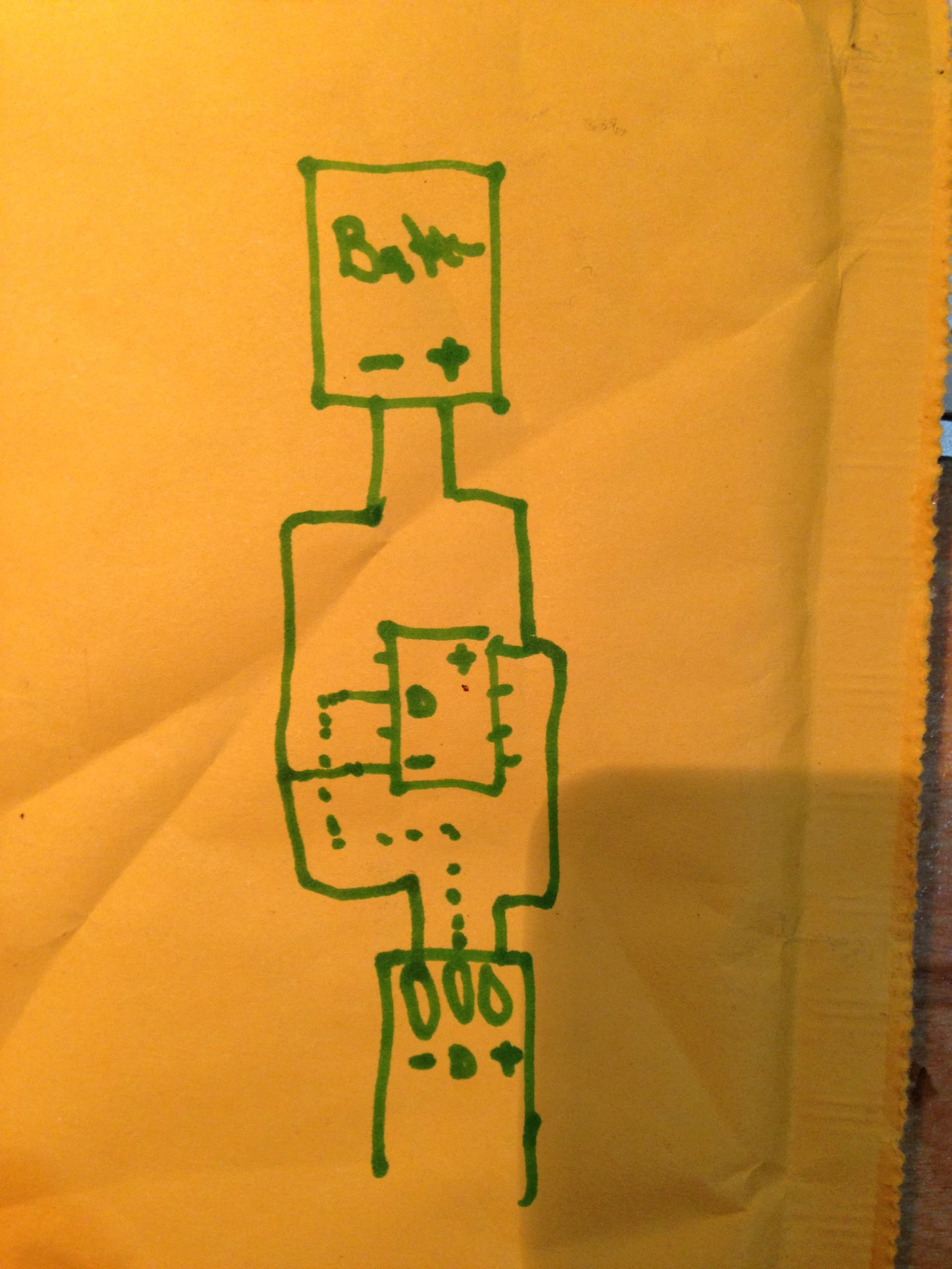

Photos for thread on attiny and ws2812

LOL. Just for grins, I created a layout with an SOIC package of the tiny85, one decoupling capacitor, one pull-up resistor on the reset line, 4 header pins output (so it can be used with clock-based strips) and the SPI header as pads along the edge of the PCB. 20mm x 10mm. That’s still thinner than most LED strips. I think the thinnest I found was 11mm. I can probably shrink it even more along the long edge but there comes a point where it’s just not worth having something that small made into a PCB anymore.

Looking at the pictures for the BlinkyTape, it just looks like a small PCB attached at the end of the string. It doesn’t appear to be part of the tape itself. So that would essentially be the same thing I did, create a tiny PCB that you could attach to the end of a strip.
That is exactly how it looks to me, too, and I’ve got one here I’m looking at. Plus, they extended the silicone over the little PCB too; it’s a great little package.
