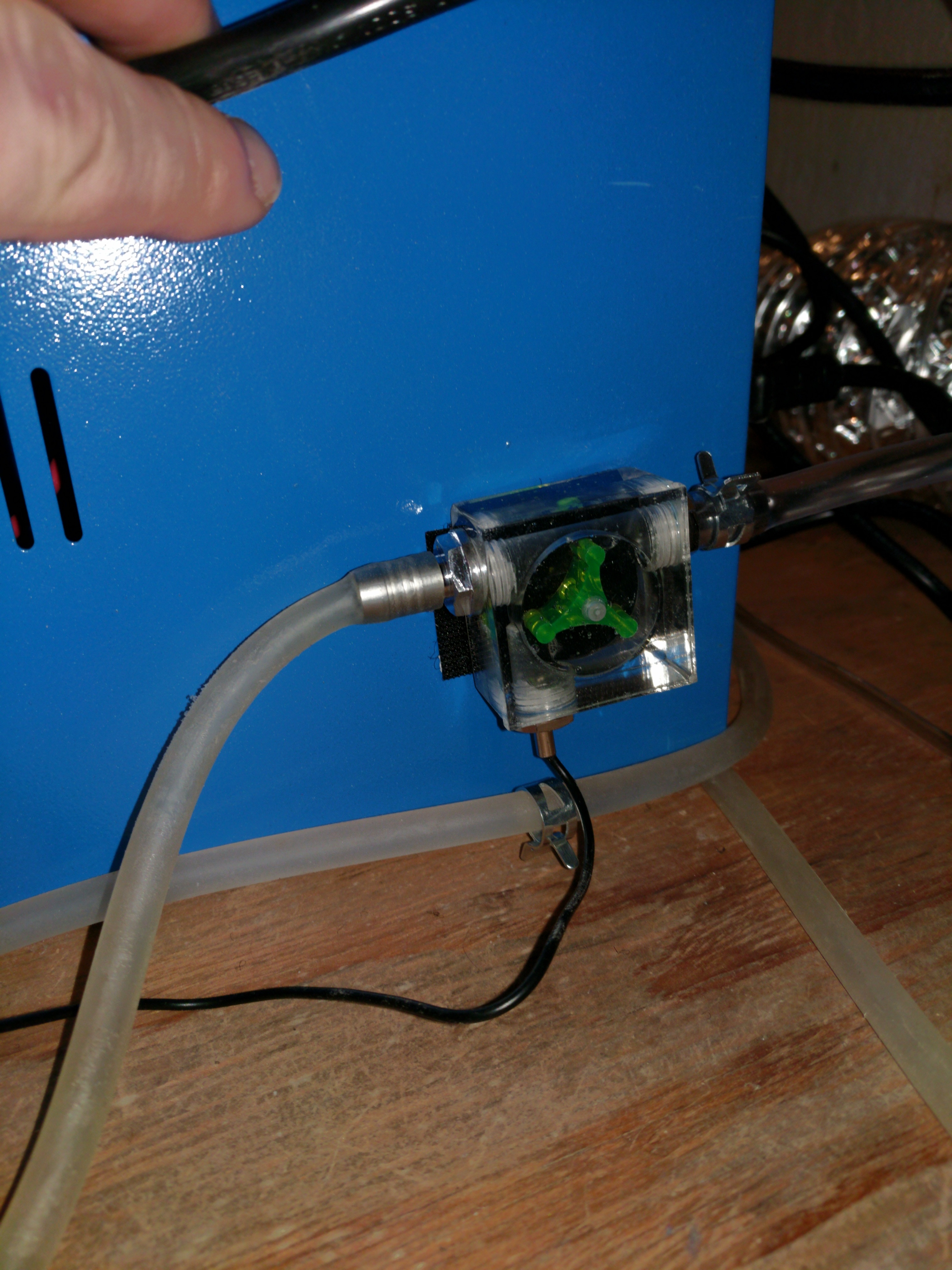

I picked up a cheap flow meter and gauge.

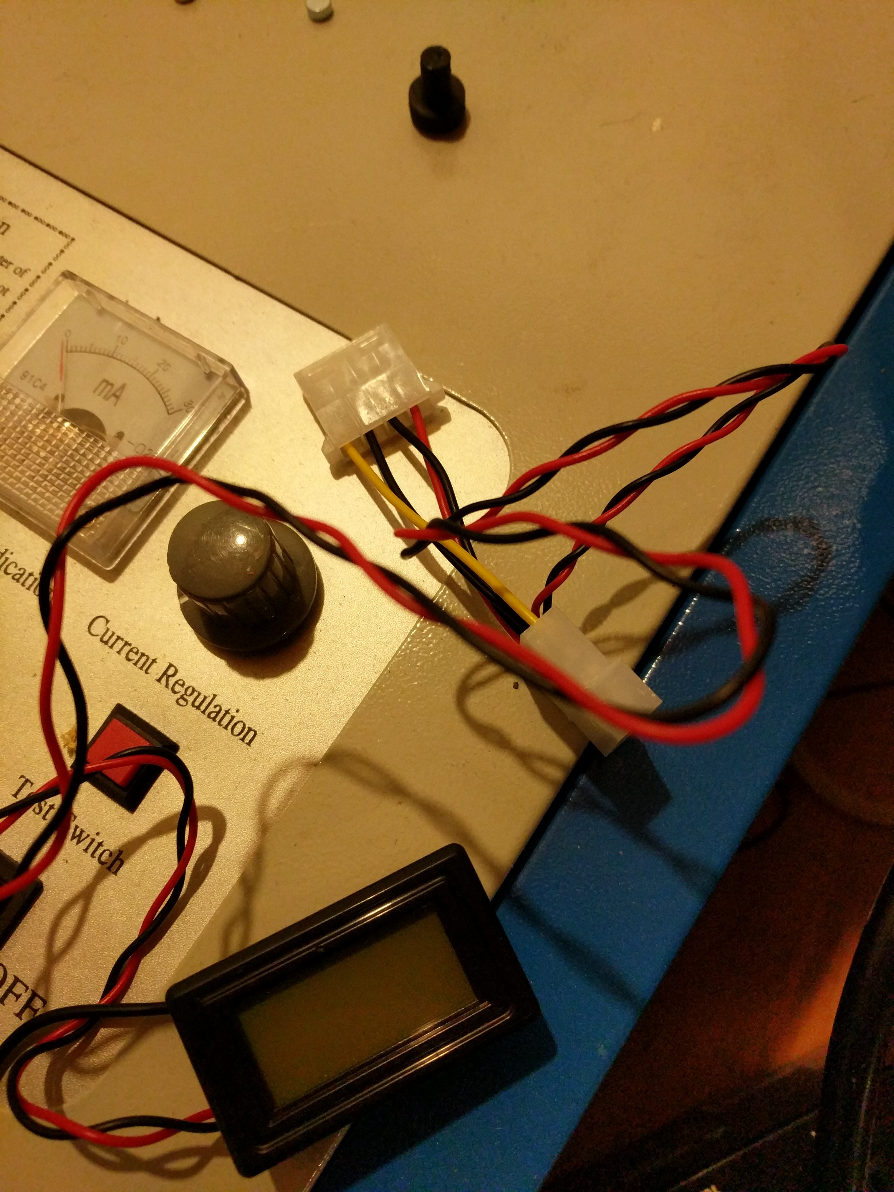

Is there anywhere to pick up 5v easily? I have a k40 with c3d conversion.
The original Psu offer 5v, but it’s not recommended to pick juice from here as it is undersized (1A).
Old phone charger around ?
What the output of your flowmeter (a value or it work like interconnect switch ?), what do you do with it ?
It’s just a visual flow meter with temperature. I will slap the temp gauge into a new panel.
I have some buck converters somewhere that I could drop from 12 or 24 if that is a preferred method.

This is what I bought:
US $9.91 36%OFF | PC Computer 3 Way Water Flow Meter Digital Thermometer for Water Cooling System Kit Water Cooling Thermometer Water Flow Meter
https://s.click.aliexpress.com/e/c2V9mWuC
Now, description says 5-24v for input… Do I trust it?

-50c, in the range but not much more than a baby bath thermometer in the bucket.
Flow watcher more than meter, not able to use it as security in case the pump isn’t on, which limit the interest.

If you are up on the control panel there is 5v going to the POT or the digital panel.
There are schematics in the posts on my blog.
The specs do not say how much power this draws but I would expect it to be minimal.
If you are running the C3D on the original supply its already marginal.
If not then there should be plenty of power for this.
This is a visual flow indicator with a temp gauge. It and will not shut down the laser on an over temp.
I suggest adding a flow switch as well (I have both visual and electric).
If you overheat you may not see the visual meter and you will loose a tube.

So @y2kvfr to summarize, if you have the extra 24V power supply they recommended for the C3D board you could tap into that. If not, then your probably need to power it with an external power source since the stock LPS isn’t really sufficient, in our opinion, to power anything else. Also it’s recommended to have a interlock on your water flow :slight_smile:
