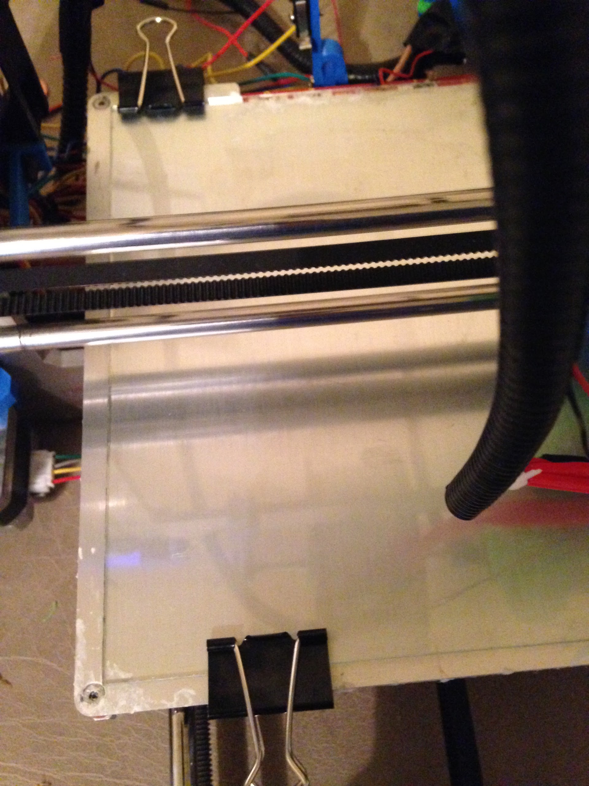

Picked up 4 sheets of glass, binder clips, aquanet. Test running :).
Picked up 4 sheets of glass, binder clips, aquanet. Test running :). If this beats the glue sticks then I’m sold.

Yea looks like it. I ran out of glue sticks quite fast. I print quite a bit. Already have gone through over 3 lb of filament
@ThantiK Yep, PEI sheet requires only cleaning and that’s it. When printing some bigger parts in ABS, you just need to make sure that first layer is good.
Using PEI too! No scraping - in fact, don’t. Cooling usually separates it. If it’s really sticking, unclip the glass and pop it in the freezer for 10 minutes.
I’ve been doing 3mm brim with abs and pla.
Usually I don’t need brim at all with ABS. If part is very thin, then I may use.
