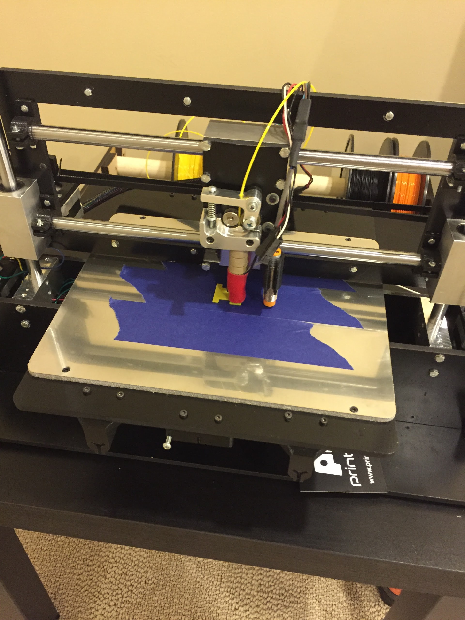

Picked up a nice sheet of aluminum and plasma cut it to add my
Picked up a nice sheet of aluminum and plasma cut it to add my heated bed under it when it arrives. Because I don’t have glass any more I don’t need my custom Frankenbot firmware so I flashed back to RevF_F5.hex. The problem is that now my y axis is backwards. It will home and then call my home 200. Is there any easy way to fix it? My prints are coming out mirrored in the Y axis as well. With the smartrap I just had the X and Y flipped. Could that be the problem here?? I just set them up how they used to be.

You can flip the connector for the stepper that is backwards. You also can do it in the firmware.
