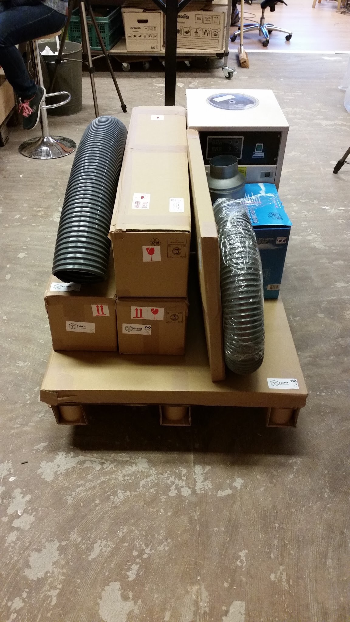

Pictures of my unpacking and assembly. For the frame build it is usefull to have a helper as the frame does get heavy at some point.
Great pics ! Enjoy your first cuts
