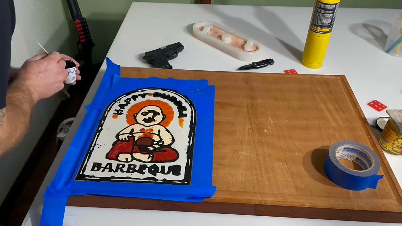

Shane did a couple of presentations for the SDFWA and shared lots of handy details. Here’s his own video. Shane started doing CNC work and then working with epoxy after he tore a shoulder and had surgery and couldn’t work for months. He excelled at the techniques as you will see. Also, I don’t use V-Carve or any of the software these guys talk about and you are the same just look for the techniques and get a beer when they go on about finding a setting or lots of Vectrics type stuff.
And here’s a video where he presented at SDFWA:
