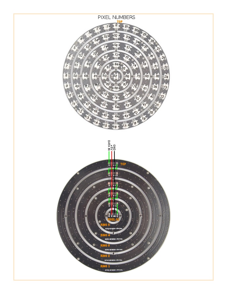

This is the pixel map for the Mokungit 93 Leds WS2812B 5050 RGB LED Ring Lamp Light with Integrated Drivers
Ring 2 and 3 are disconnected on that graph.
Yes, you are right. There should be a green wire from ring 2 to 3
I’ll post a corrected pix.
