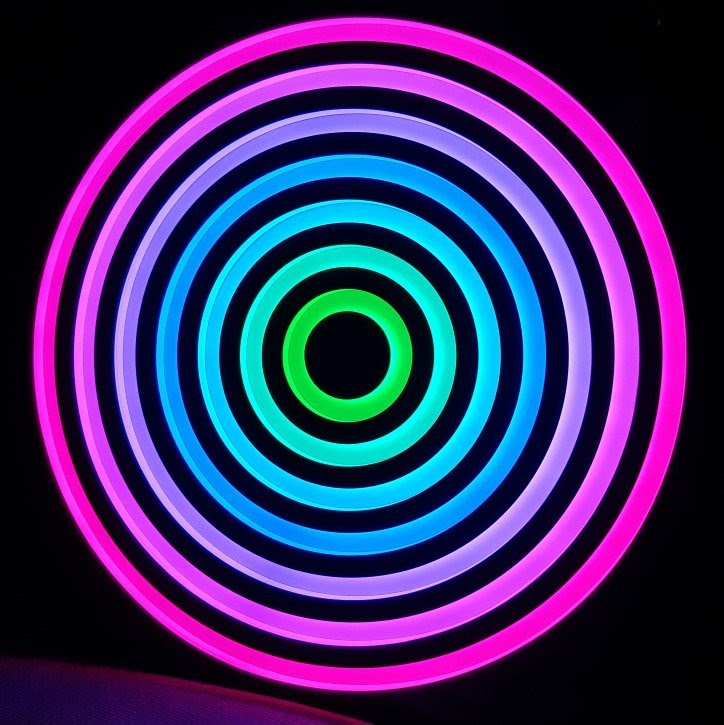

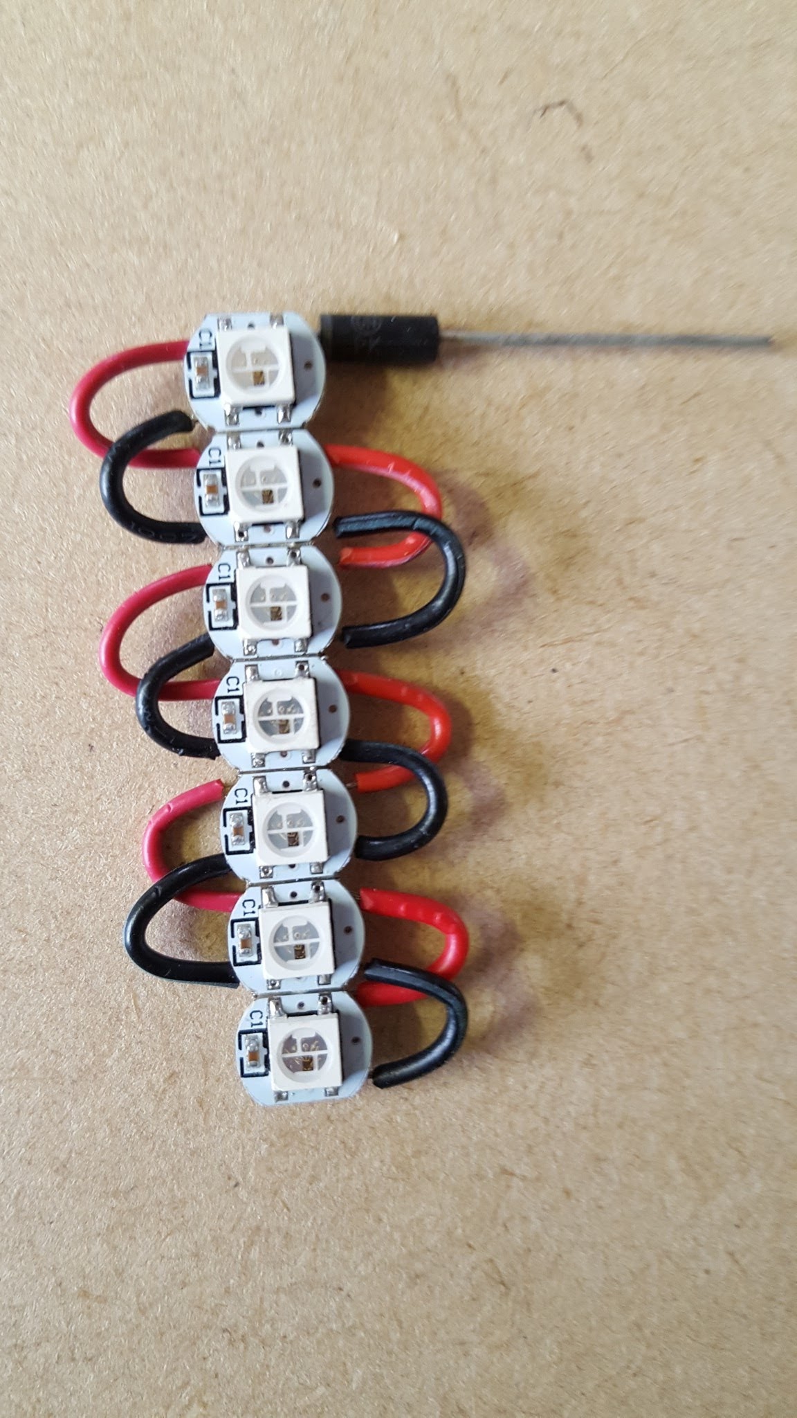

I figured as much… Swapped it for a 3.2. All working now…
And with my custom Octo board :slight_smile:
