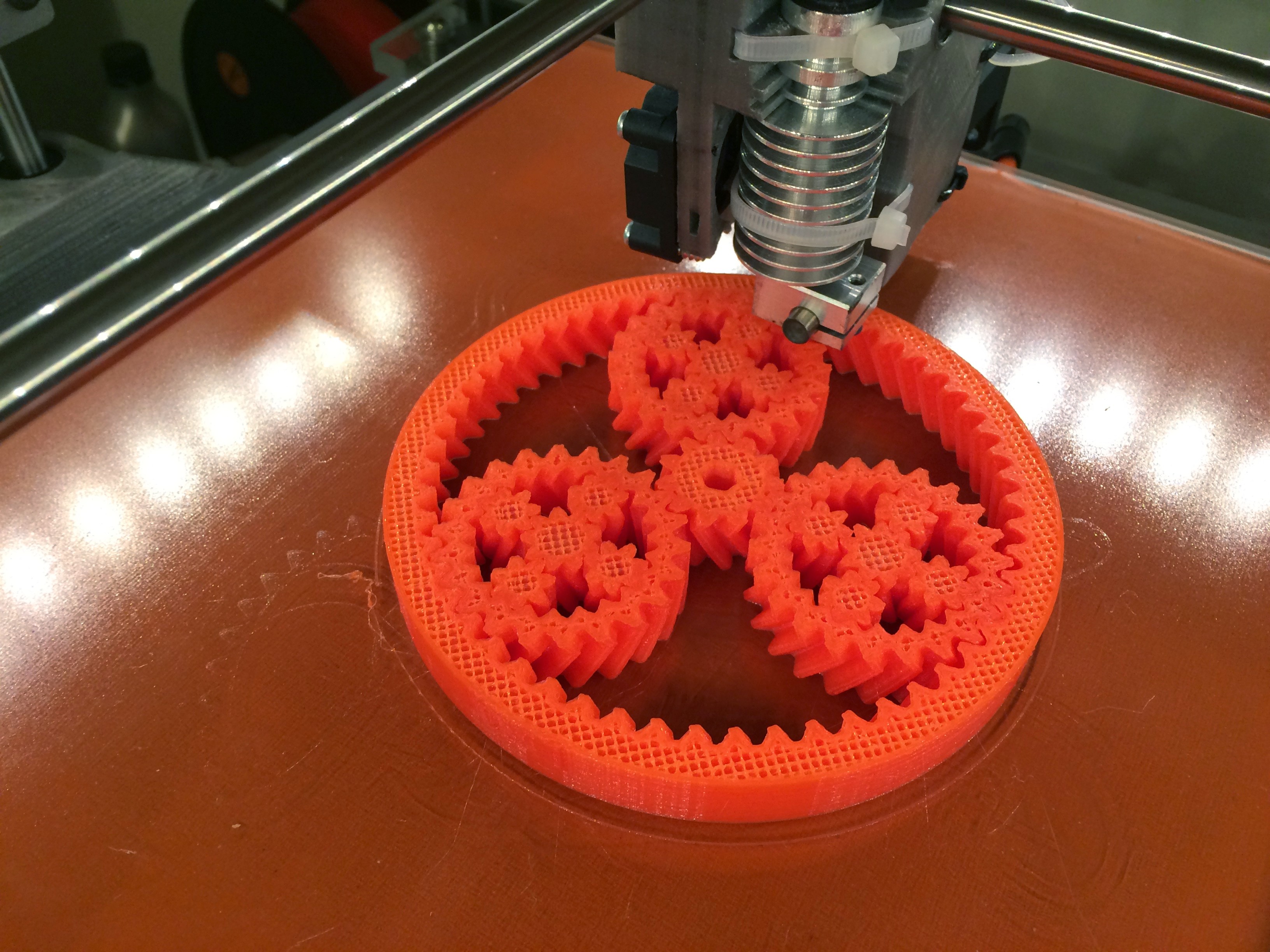

PLA, 90mm/s, 240C, .8mm outer shell, .15mm layer height, 70C bed temp, http://www.thingiverse.com/thing:264769 - not happy about the thingiverse link
Originally shared by Jason Smith (Birds Of Paradise FPV)
So far so good. This is a long print…11hrs. Hopefully it won’t be too “stuck” together when it’s done.
Eclsnowman
(Eric Lien)
December 31, 2014, 2:17am
2
I have trouble cooling pla for gear prints like this at those speeds … Always ends up fused.
Great job.
Bit of a silly design though no?
Unless you have a spider driving the planets, the internal bearings don’t do anything do they?
Yup didn’t look, prefer not to give thingiverse traffic.
That’s a slick design though. Makes me want to drive both inputs on it and build a hybrid ~something~.
You could always use Cura to split the design up so the parts have more spacing during printing. A trick I was told by the good folk here only days ago…
