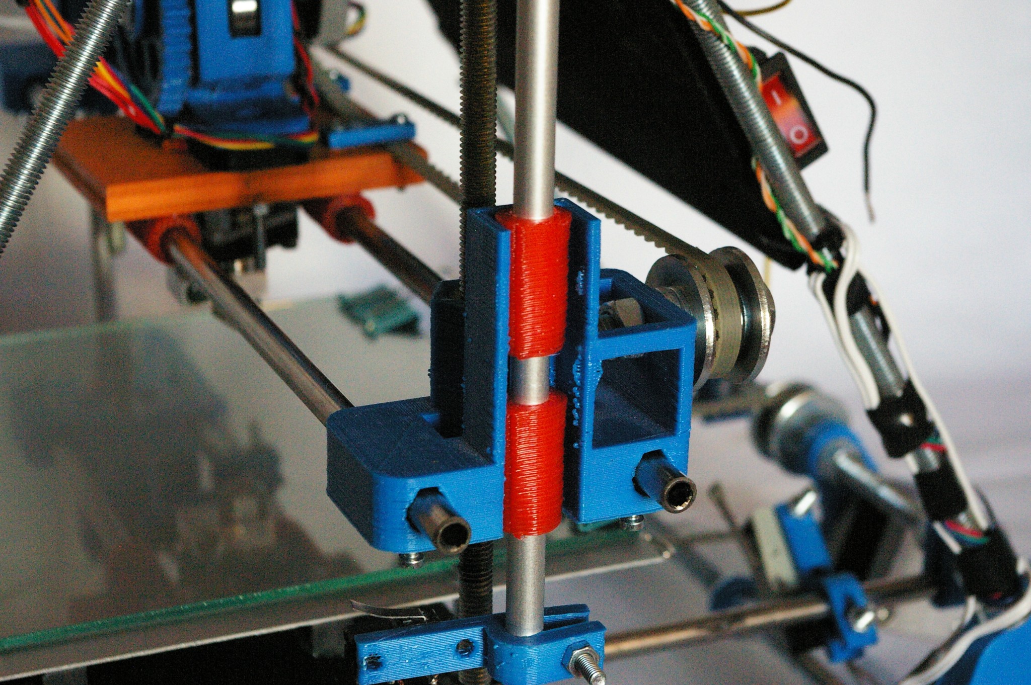

Plastic bearings for rep rap Z axis.
By chance is that Nylon? - I’ve used PLA in the past and they really really suck for anything more than short-term stand-ins.
I dunno, on the Z axis they’re probably ok, it moves so slow. and nowhere near as much as the other two axes.
I maded it in PLA, and i used it in X axis too and still printing very well. I think that the point is keep th rods plenty of lubricant. Im glad you like it guys
I recently upgraded the Buko Z Axis bearings to $.05 plastic tubing. Works great

I have made a few printers for teachers at my school and I always make my bearings out of ABS and they all work awesome. I’ve been using it for a long time and they don’t seam to be breaking down at all.

No really my z works awesome ive been running on it for about 6 months with no problems. I also ziptied mine in just to make sure they dont move around much.
yea ABS z-axis seems to be pretty unpredictable but some machines last months with them. Mine fell apart in about 4 weeks.
