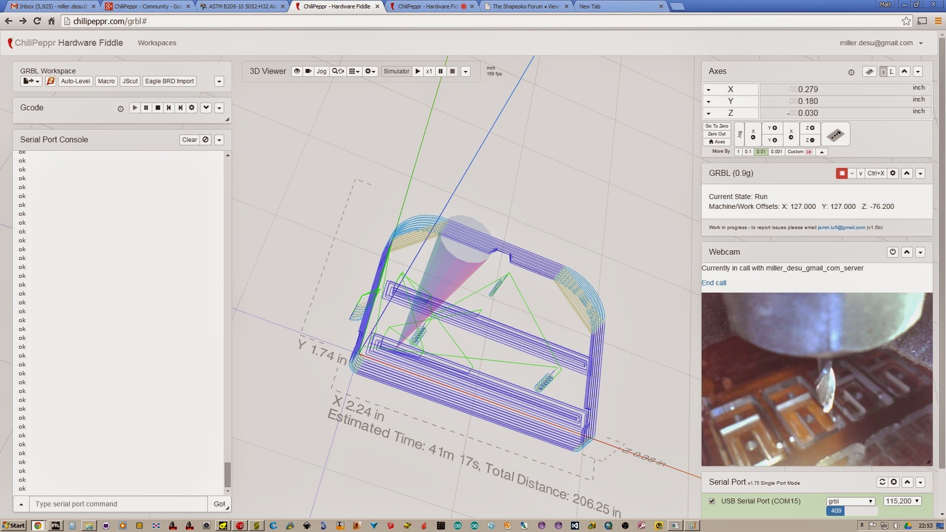

Playing around in ChiliPeppr tonight. Might have to abandon GRBL Controller!
Is there a way to highlight the completed tool paths in the 3D viewer?

Hi Matt, that feature is inches away. A couple weeks ago the âonExecutedâ event was published for TinyG which means you know the exact line number being executed at any moment (itâs rare to know in CNC-land the exact line being executed). You could now just tell the 3D viewer to set opacity for any line not executed to say 0.2 (20%) and every line that has been executed to 1.0 (100%).
For Grbl, which I see youâre using, you wonât get the modern-day features like onExecuted, but you will get onCompleted, which means youâll at least know where the CNC controller is at within say 10 to 20 lines of gcode.
If you look at how the checkmarks are updated in the Gcode widget, the 3D viewer would just update on itâs own using the same onCompleted/onExecuted technique.
If youâre up for it, you could do this via a macro and/or fork the 3D viewer widget and sort of steal the callback events from the Gcode widget and shove them into the 3D viewer.
