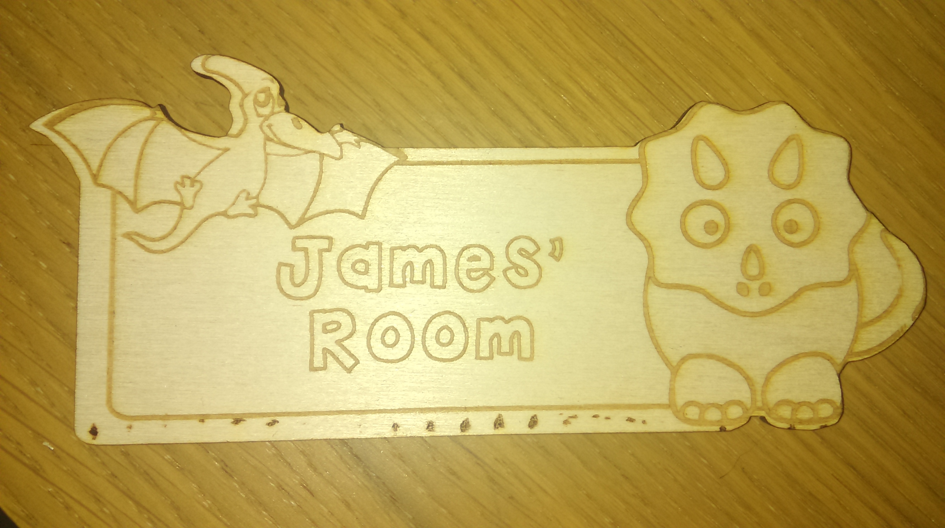

Please can anyone offer some advice? My laser is fantastic, standard apart from cutting table. But just recently when engraving a project by the time it gets to the right or bottom the picture is out of alignment, the below was cut with Sino at the top and flying dino at bottom, the design is good but when etching the frying Sino is out of alignment . Please any help welcome.
This has to be a software issue. If it were a mechanical or calibration problem, the raster and cut would have the same issues, thus not be noticeable or there would be a hard shift in one or the other. This appears to be a gradual drift, like the cut and raster scaling are not the same.

In Corel laser click on the settings cog and change the cutting data from HGPL to WMF. Also check that your engraving data is WMF. This should fix your problem.
@David_Wakely i can see how this works and it does (Kind of) but when it cuts it cuts extra lines that arent in my design, i did get results setting them both as Jpeg but cuts everything twice

Are your objects solid fill in corel draw? if they are not it will cut twice when using WMF.

That’s interesting, never solid filled, I just make sure all lines are 0.7mm or lower otherwise the machine would cut twice. Stupidly, the hairline setting in Corel is over that, hence the double cuts.
