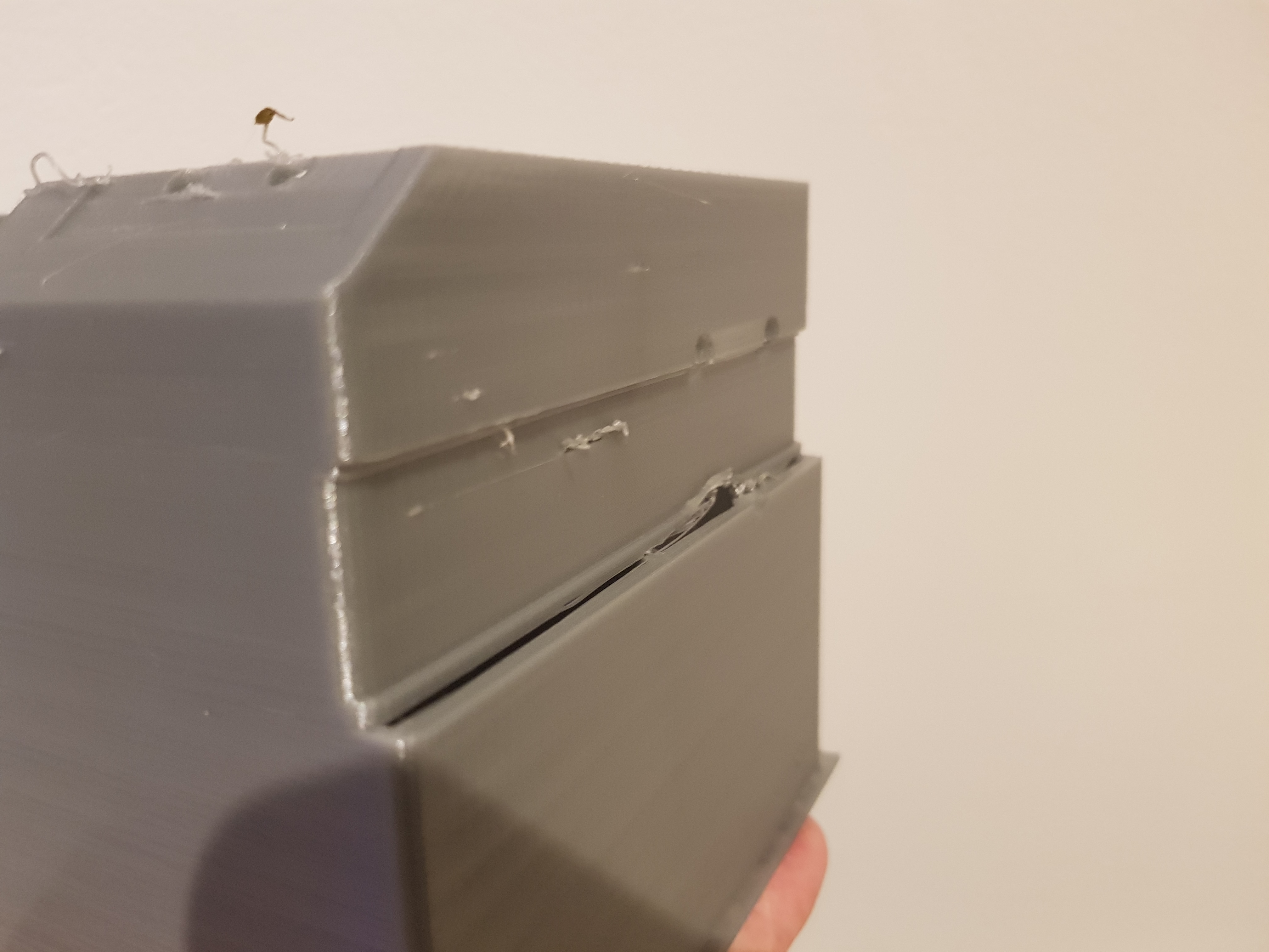

Please help in solving below issue.
Please help in solving below issue. This is the 3th or the 4th fail print(almost used one complete roll). All the time is start to give error at same chanfer hole. I wander if is a problem with printer or with my model?

Looking at the pic, I don’t see any infill inside that gap (I’m presuming this is a solid box?): If that’s true, it means you’re printing that internal ledge over empty space, and over time that bridge is probably failing. Either put some infill in there to support that internal overhang, or change the model so that isn’t a 90 deg corner, but a 45 deg-ish chamfer.

Looks like a layer shift to me. Something at that point/height in the model is apparently triggering this.

@Jeff_Parish : Agreed. Looking at a pic of the model, the whole print seems shifted for a section, which either could be caused by mechanics, or a bad slice. I presume you slicer lets you preview the results, and it doesn’t look like this?
@Pop_Gheorghe Curious. What does it look like on the opposite side? Is it shifted out?
@Eric_Pavey @Jeff_Parish from the marked hole it shifts out. 3 times at the same poin with a diference of 1-2 mm. And yes, also on the other side is shifted.
@Pop_Gheorghe , 2 things. A) Check pulleys, make sure set screws are tightened down. B) If your drivers have heatsinks, put a little fan near them and try again - you might be reaching a point where they thermally shut off…specifically the X motor.
Additionally, reprint with the “netfabb fixed” version - your software might not be showing triangle faces properly.
