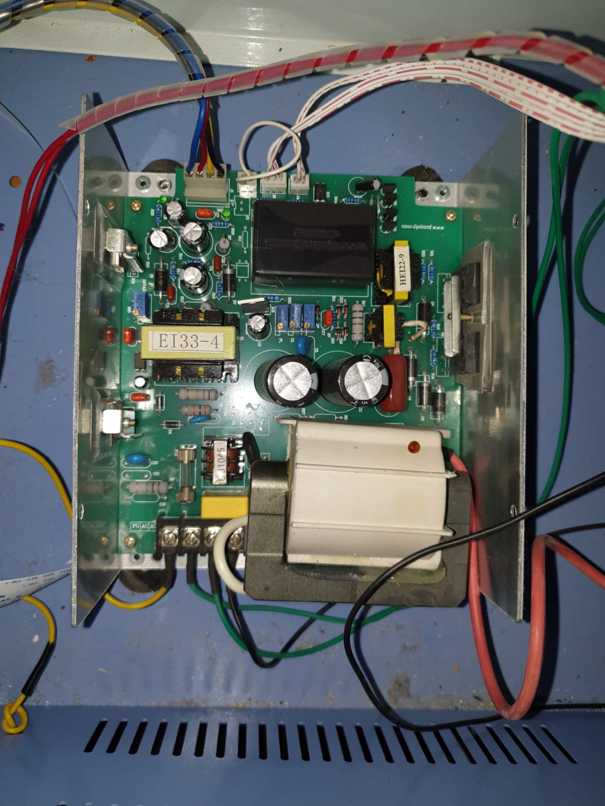

No interlocks… my unit is basically stock, power supply doesn’t even have the test button on it :see_no_evil:
Thanks Don, I did go through this flow chart guide earlier today and ended up at “S” - buy a new one or repair… :frowning_face:
Yeah, I feel your pain. Earlier this year I thought my tube had died but it ended up being the power supply. But with a new tube and power supply my laser is running better than new.
Oh it sucks big time… So should I upgrade my power supply to the Cloudray? My connections are different but I assume it will all work out the same.
Is this an old machine?
I have never seen a supply like that one!
Is that a black box in the center top? Is that a cover that comes off?
Looks like no matter what you get you will have to do some rewiring…are you up to that?
It’s circa 2014 from Aliexpress and I’ve wanted to hurl this machine off the balcony so many times lol
We’re a two engineer household so between the husband and I, we should be able to work it out :crossed_fingers:
ps. I have no idea what the black box is and the I tried to pull on it and it’s not a cover that comes off… I’ll send it your way eventually when I get myself sorted, it can be a new addition to your K40 LPS museum :upside_down_face:

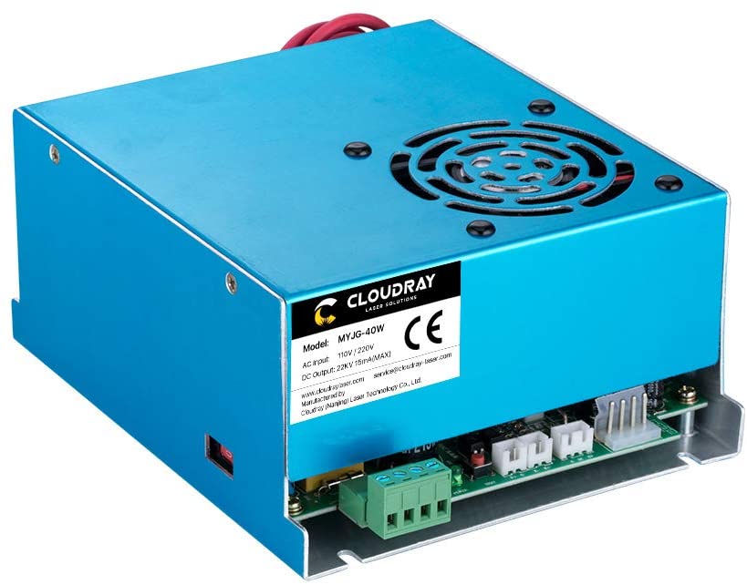

Bahrain… This is what I’m ready to get because I need express shipping:
That will require rewiring such as:
  1. The ac from the back of your supply will have to be moved to the left green connector,
  2. The white 4 pin DC connector (rightmost) on yours will have to be cut off and rewired to the rightmost Green connector.
  3. The middle two white connectors will have to be cut off and rewired to the middle green connectors
Generally not to tough because the new supply has screw terminals and I can provide you a schematic if needed.
Here is my affiliate link :slight_smile: for the 40W: https://amzn.to/2WssAeD
If you are thinking about an upgrade to the K40 controller and power later you may consider that there is also a 50W: https://amzn.to/2Fdysmr [but you have to also buy a DC supply]. Keep in mind that in the DC supply in the K40 is under powered if you do a controller upgrade.
Just found this one that is more of a direct replacement.
You would only have to move the AC power connections:
