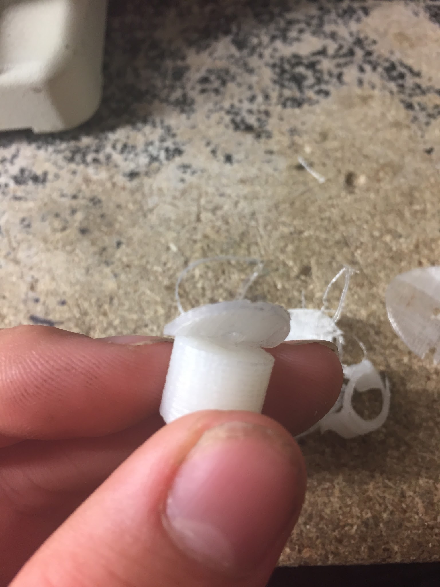

Hi! I finally built my self a drying bucket to dry my Nylon 910 alloy filament, and i’ve been trying to print with it. I’ve come across some problems.
First off, the layers are peeling apart easily after printing, like so easy that you can peel it apart with your fingers. Second, when the print gets to the top (where its a bit thinner) it starts to get all deformed and seems to be under extruding a bit. I’m really getting frustrated at this point, and I would greatly, greatly appreciate any help!

I had identical issues when I first started out with 910. The layer de-lamination is most certainly moisture related. A good drying session resolved this issue for me. To be honest, I was also frustrated at first and dumped the roll back in the drying bucket for about a month. When I got back to trying it the issue went away, hence my determination it was moisture. (Nylon can be very difficult to dry if it has been exposed to moisture for some time). As for your second problem, it is just too much concentrated heat for the thinner sections. If you watch closely you’ll see the previous layer or two is partially or completely molten, so the layer being printed doesn’t stay in place. In fact the new material from the nozzle just “pulls” the previous material along with the nozzle movement. I have similar issues with other high temp materials like PC as well. I’ve had very good success running the layer cooling fan at between 30 to 60% in the thinner areas. (In S3D you can set the fan to turn on at specified layer). If you have an enclosed printer you can also try keeping it open for the smaller parts. Your settings look OK. I can’t recall at the moment my nozzle temp, but I think I run at 255 or 260. I run my bed a bit hotter, about 60, but that’s because I’m heating the aluminum bed plus 6mm of glass. With those temps I can run up to 60mm/s print speed, at both of those layer heights. Good luck and let us know if any of this helps. Cheers. PS. I love my 910 so much now I print almost everything with it! Too bad my roll just ran out

To me it looks alot like a slight under extrusion (you may try 104% or 1.04 factor depending on your host) and you might be printing a little to hot. Nylon can be very very difficult to be printed reliably. Actually i don’t dry my Nylon filaments at all! since those micro bubles in a print create a uneven surface were the next layer may stick better onto. That creates a less beatiful outer surface though.

Klaus, my apologies for coming across offensive, I didn’t intend that. My point was simply that your printing methodology (wet, over-extrusion) is against typical advice for nylon. But if it works, then go for it. In fact, I might be inclined to try your technique the next time I have wet nylon and no patience waiting for it to dry. I also agree with your point that in the photos of the part does appear to be under-extruded, though I’m not convinced that over-extruding is the solution as there may be other print settings causing this to happen.
