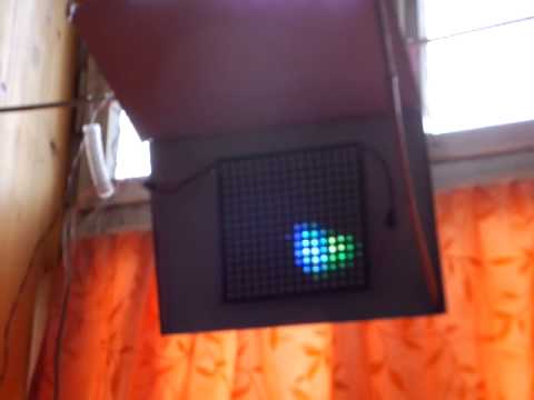

@Stefan_Petrick If I am understanding the Funky Clouds stuff right, it requires another input (MSGEQ7 or oscillator or something) to run, is that right? Is it possible to run this code just with an Arduino (I’m using a micro) and just let it groove on its own?
This version doesnt need the MSGEQ7… it should run on its own… i think V3 is when he starts to use it.
oh sure enough. Look at that. Thanks!
@Erin_St_Blaine It´s very specific code for a 16x16 array. Not easy to adapt…
If you send a picture of your setup (where are the LEDs and connected in which way) i could help you with the mapping. And yes, it grooves driven by oscillators (basically byte counters). No MSGEQ7 needed. Arduino is fine.
@Randal_B The MSGEQ7 reading in the alpha version (what you call V3) is just an add-on. It basically doesn´t matter, where the data comes from. Could be also an oscillator (a swinging sinus based on an integer counting linear up) or random numbers with interpolation inbetween or noise or you name it.
