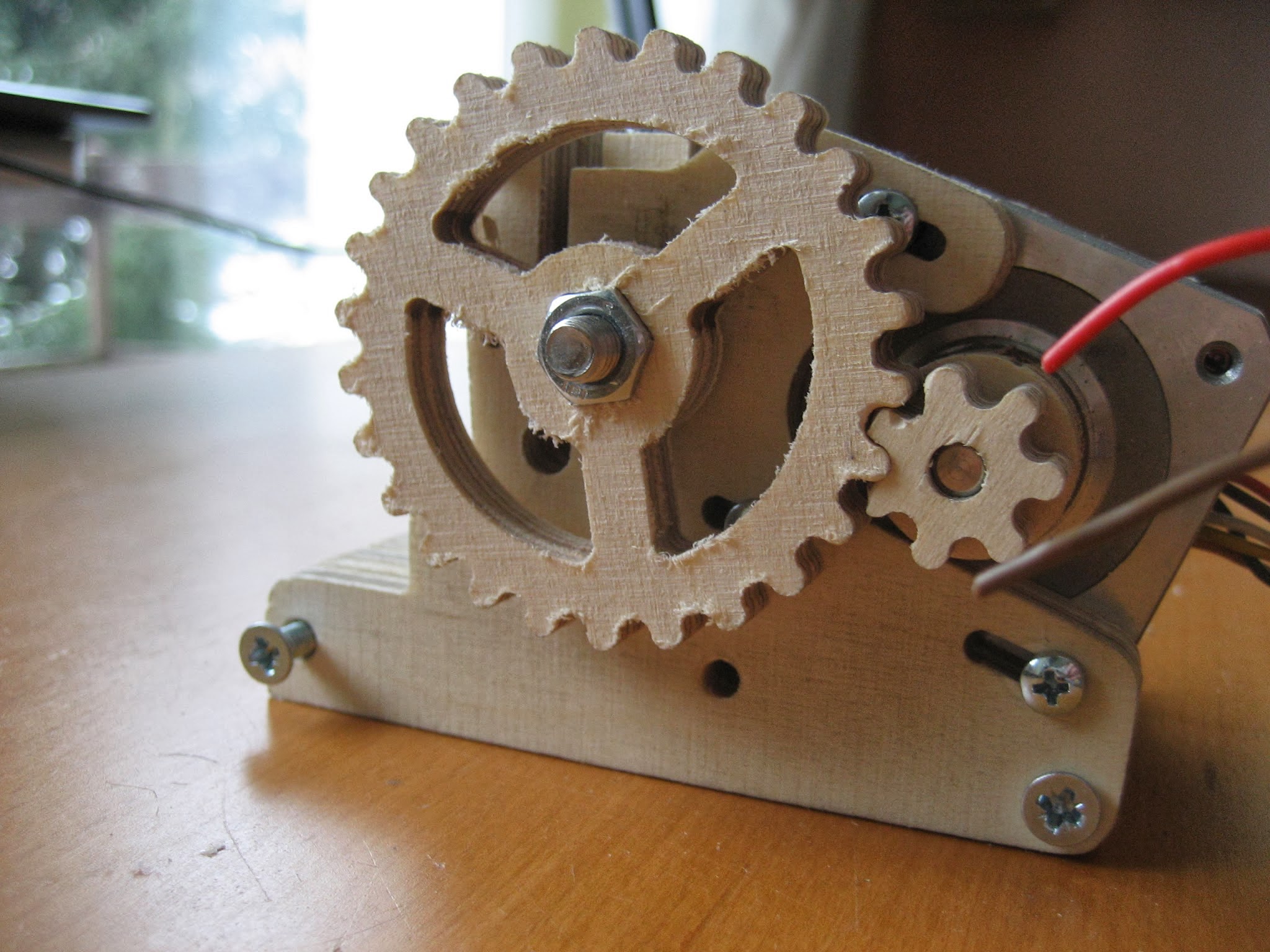

Plywood extruder. Not exactly extruding plywood but extruder made from it ;D
The big gear looks more like MDF to me
looks nice, only downside is the wood will end up with a groove and the filament will be slipping relatively quickly. Might want to make sure the part holding the filament is a bit more durable than the rest :slight_smile:

Great work! you have managed to make a compete model of printer that one can make without need of any printed parts. If I knew it’s possible 6 months ago my ife would have possbily been completely different :slight_smile:

@Thomas_T_Sorensen look to the inside of the big gear. There should clearly see the light and dark layer pattern distinct to laminated woods especially plywood

Only plywood, it is great material. I will get to know if it works in few days. Currently I’m working at stiffness of X axis of BYQ.
In the end, plans are going to be released at my github. Stay tuned :wink:
Gears are drawn at draftsight, tooth is round and it works relatively without friction.

I’m going to use very strong casting plywood which is used at construction site to pure concrete into foundation of house. It is much more stronger and stiff. Of course if there is such need.

I’m inspired by yegah/yruds. This extruder is developed by myself.
