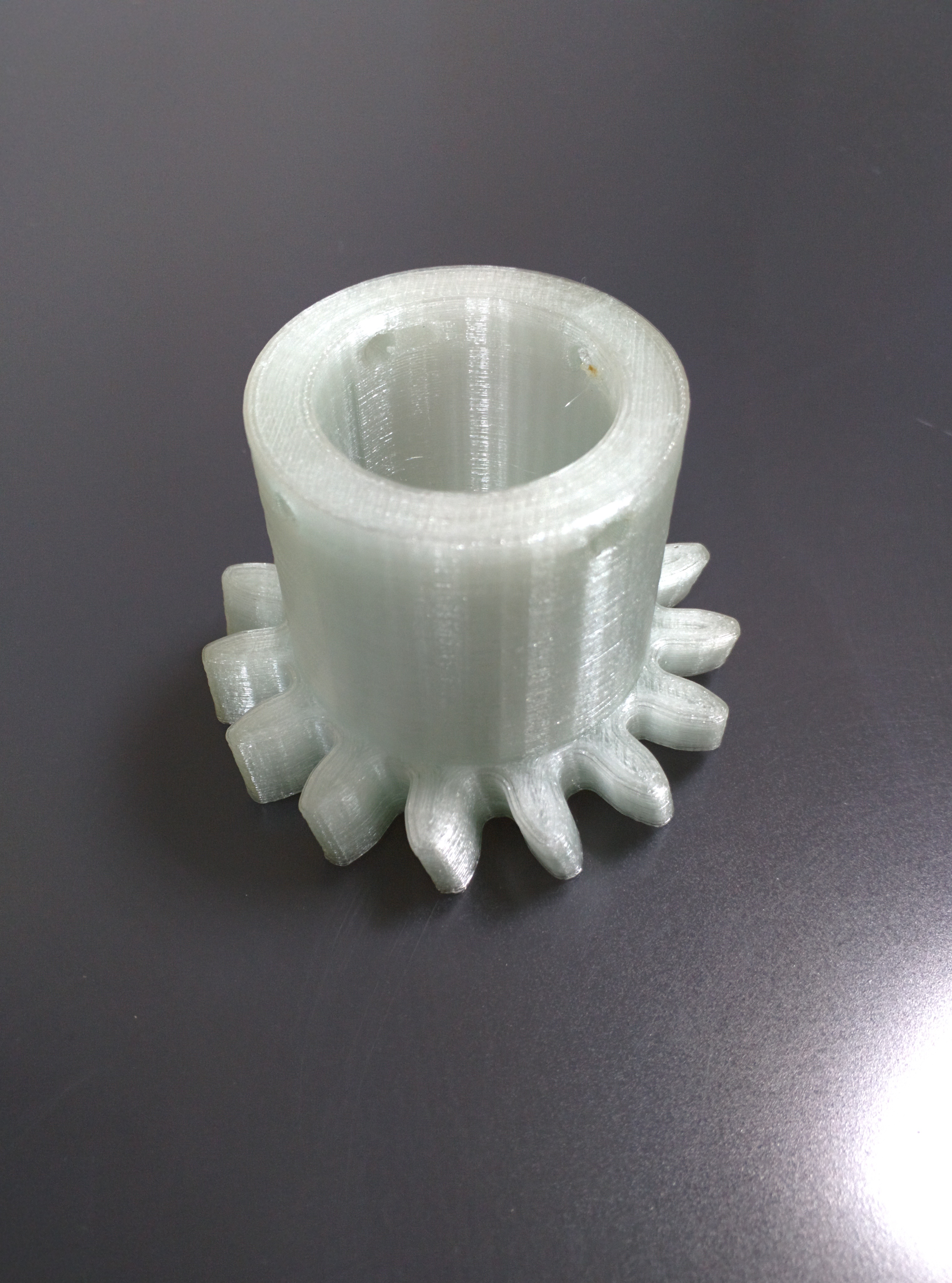

Polycarbonate gear gael langevin ​
Polycarbonate #inmoov gear @gael_langevin

what do you use for adhesive on the Bed to make it stick? i have PC filament but at 110 degrees Celsius it still not sticking to the bed
I put kapton and superglue on it. Also, printed with raft. It stuck pretty well
