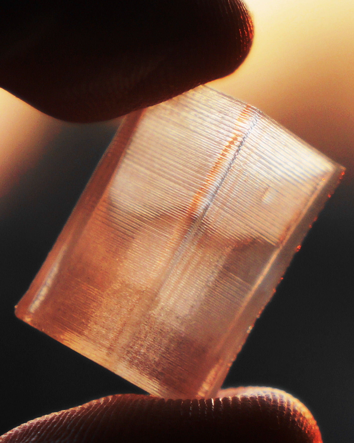

just fantastic, prints well, looks good and is super strong.
temp at 232°C with 25% inceased flow (viscosity compensation)
The probe cuvette is two walled at bottom with air-gap — merging into singlewalled at top.

Wow surprised it prints at such a low temp. How’s the layer adhesion?
It is like one piece … (without the increased flow it become less translucent and with a bad layer adhesion)
@Ulrich_Baer why you made it double walled ?
It is a »probe« to see at which distance two walls fuse together.
