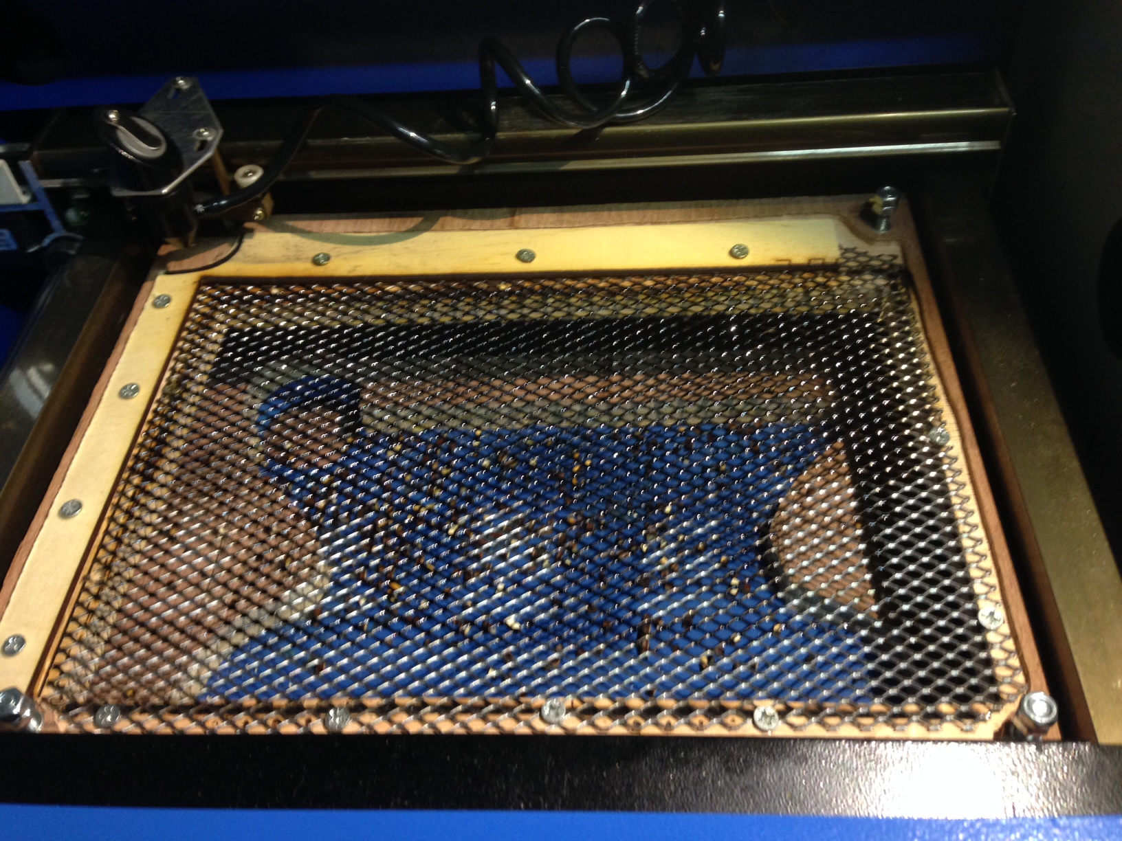

Poor mans manual z bed,
Poor mans manual z bed, You will see by the pictures that my intention was to make more of it. On the last picture you will see Pulleys that are only for decoration. I an very happy with the way this is working. It does mean you have to adjust each corner one at a time. I have found that as long as your laser head is level you can use a spirit lever and it doesn’t take very long to adjust. You will also see that I have some 3mm ply attached which is great for referencing the position. Anyway any comment good or bad. This was meant to be a rought attempt but I may keep it as is.
Looks pretty good, do you get any reflection problems with that mesh?
No nor really works better than every thing else i have tried, but i haven’t tried honeycomb yet.
