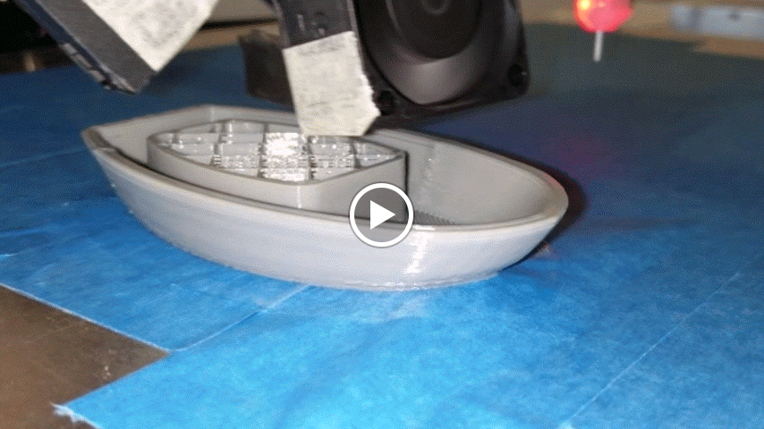

Posting a video of printing of the boat. See my previous post.

It’s too help resolve ugliness.
Looks like it’s too much retraction.
I’ll be giving it a another try tonight…

It looks like it sliced it weird, but it’s not stopping as much as I thought. Check the gcode with a gcode viewer.
I’ll check retraction settings and try again
To me the route seems strange. The head always changes direction after a loop. Why wouldn’t it loop in one direction? Is that a slicer setting, too? I had printed the #3DBenchy which is also a boat. The perimeter was always looped in one direction. (My time lapse video is too sparse; here is one 9 second snapshot at the very beginning: https://plus.google.com/u/0/photos/+YuanLiuTheDoc/albums/6268087513315713505/6268098494688093474)
