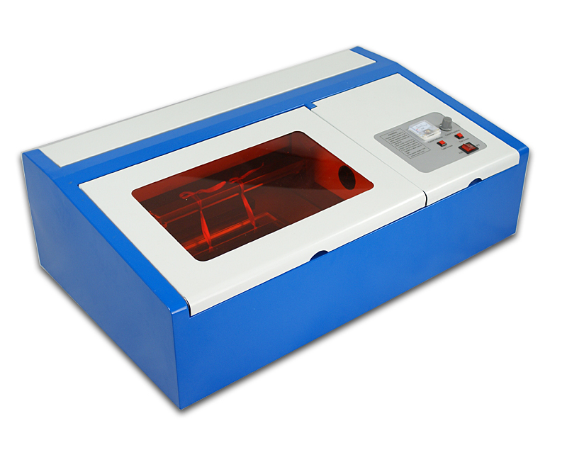

Potentiometer control panel update
Analog-to-digital upgrade for better power control
Are you looking for instructions how to convert it ?
Let me know and i´ll show you (or someone else quicker
Actually going digital will make fine tuning the K40 harder not easier. The power is not linear and using a 10 turn pot gives finer adjustability than a digital to analog circuit.
