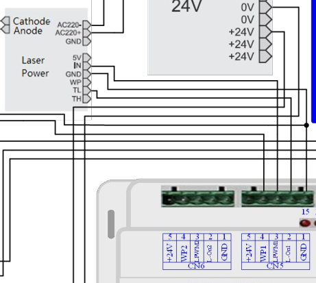

This is how the stock K40 and the Cohesion3D/Smoothie controllers are configured to operate.
The PWM output of the controller is connected to the L signal while the IN signal is held via POT controlled voltage to the maximum current you want going through the laser tube.
I’ve heard of people trying to do control in the opposite way but I thought it was putting an analog input into IN and using L as enable(ON/OFF). Your posted pic shows you have it working using dithering( not grayscale/analog control ) which really means there’s just ON/OFF control needed since the color/depth of the burn is a function of how long the laser is on not how much power is run through the laser. Did I get that right?
The first image shows that the pwm width can change, which is what I’d expect from a gray scale image.
Many of the lps, that I’ve looked at will take an analog or digital input to the IN of the lps.

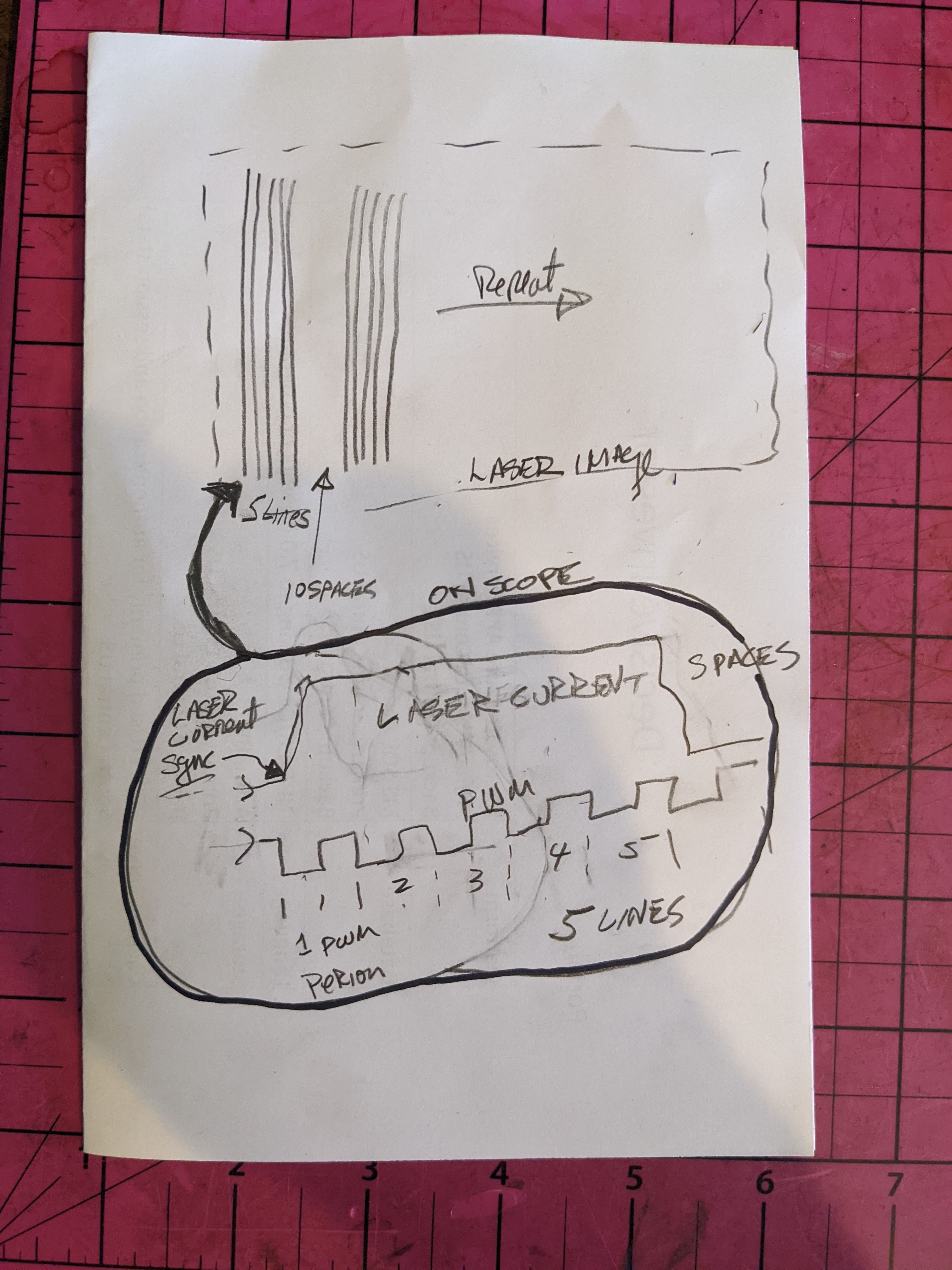

Here is the idea:
  • Create a pattern of 5 on and 10 off that repeats horizontally.
  • The scope sync is set on the laser current (might be unstable so adjust sync level)
  • Look at the PWM on second trace.
  • If the pattern repeats faithfully then you can sync on any combination of 5 without much jitter. OR use storage mode.
  • You can tell where the sync occurs because you can count the five periods of PWM.
Alternately make only one pattern of 5 that does not repeat and see if the above setup works better. The time between groups will be much longer however.
Try this also syncing on the PWM. Again you can tell where you are by looking at the groupings.

Using IN for PWM and L for enable:
In your setup with the PWM controlling IN the max power is only controlled by the PWM value. The L signal enables firing.
I do not like this approach because the only max control is the programmed PWM. This means that as the laser wears you have to adjust each program vs just adjusting a pot.
Note: the total power in these supplies = L [df] * IN [df]
This is wired up as specified by the controller manufacturer, Ruida.

So I’m wondering what is in the IN circuit of the LPS which results in the proportional voltage of the PWM input.
The IN is an analog input that controls a PWM IC that drives a high voltage H switch. Yah, it’s not that simple but good enough to understand how to use the LPS optimally.
You can control IN with an analog value but a PWM would also work (its two analog values 0-5v).
That is why when the IN is set with a DC value and the L input is a PWM signal the net result is a “PWM of a PWM”. You get external offset control and the programmed PWM does not have to change as the tube deteriorates.
You can also turn the L on and off. However, you cannot externally [to the controller] set power this way.
And there are ways to disable the LPS via other inputs if you want to other than L.

I think I need to look at how the K40 is wired and how the pwm is used. Does the K40 produce a pwm anytime you are executing a layer?
Second, the IN input is active high and the L input is active low… so a change somewhere else needs to take place for it to work properly. I think you can invert the L-ON output…

The standard way the K40(analog version) works is:
  1. The POT across 5V/IN/Gnd sets the max power output of the LPS with a DC voltage. That is fixed and is set when the machine turns on.
  2. The controller puts out PWM into the LPS-L signal control which set the laser on/off at defined power levels based on the PWM.
So ya, the PWM stops when the firmware is told to not lase anything. It’s a one wire control.
