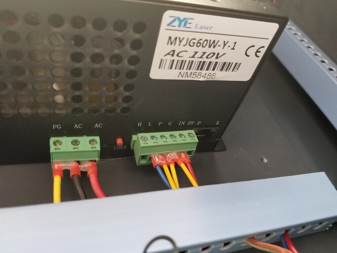

Is there really any difference from one of the lps in the ‘China Blue’ that I have and the K40 other than cost or how it’s labeled.?
I would have to see a photo of the two LPS connectors to be sure. Generally, these 40W supplies are the same. The 50-60W I have seen have an upgraded HVT but the PCB circuits are the same. That said, I have seen a few new LPS designs that are not the same as the typical K40. I have also seen 80W configurations with the same circuitry and 2x HVT’s.

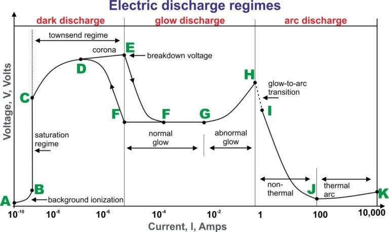

FYI: a generic discharge profile:
Have you seen this with any kind of time reference?
I’m assuming the ‘townsend regime’ is were you don’t want to operate for any extended period…?
How much time is it from start to finish?
:smiley_cat:

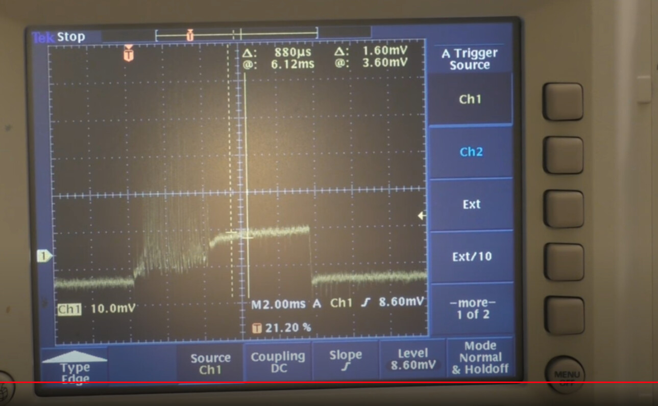

  4. Sarbarmultimedia did some work looking at the output with a scope and HV probe that showed the waveform and that satiated my curiosity.
  5. I decided to use printed patterns to measure the printed effect of response time on the image. Don's Laser Things: Measuring Laser Marking Quality
@43.51 of this video: RDWorks Learning Lab 97 Understand Your HV Power Supply via Florida - YouTube

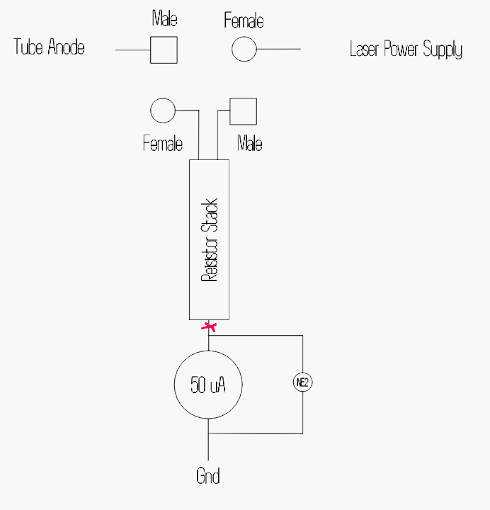

I have ‘broken’ the line going to the uA meter and inserted a 640K resistor.
Figured it would give me about a 1V to 1kV. I didn’t think I could watch it drain off… Kind of kills this idea… at least with a scope.

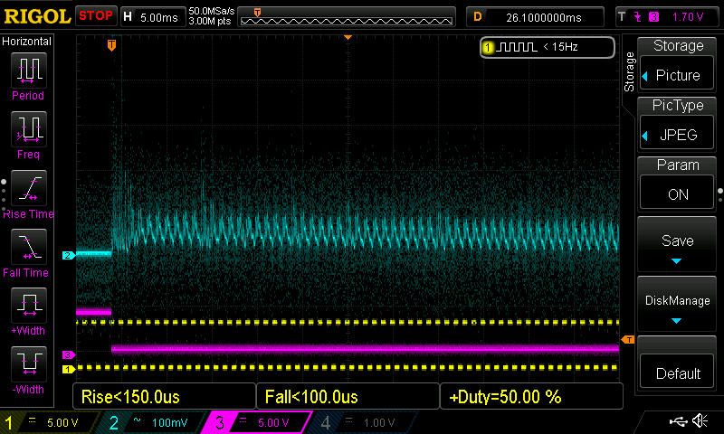

The pwm output is purple and the yellow is the voltage.
You can see where the line starts to go up that 1mS pwm pulse from the console. It’'s a single 1mS pulse at a low percentage.
Doesn’t really tell me much except I need to get at the power end :frowning:

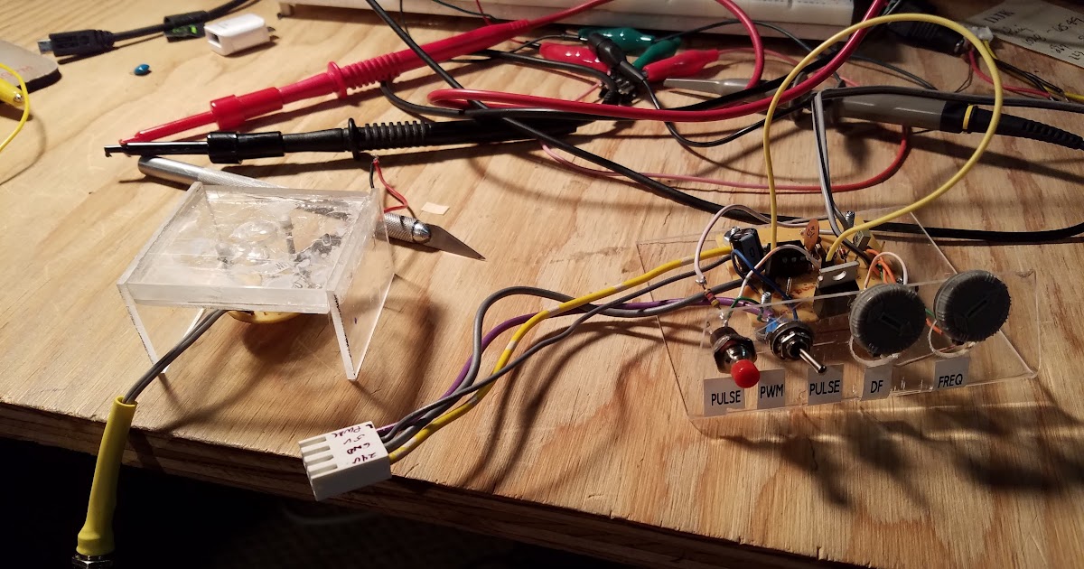

This was the test setup I built just before I abandoned the testing:

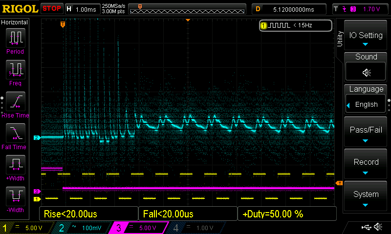

I’ve tried a few things and have my scope connected to the L-ON1 (laser enable), purple, which is also the trigger. Blue is across the 30mA meter and yellow is the pwm. PWM period set to 1mS.
Guess I’m going batty, it looks to me like the lps is ‘on’ when the laser enable goes low but the pwm doesn’t seem to change anything…
Does this make sense to you.?
Thanks…
:smiley_cat:
What does it look like if you expand the horizontal to see only one L-ON1 period?
Where are you getting PWM. I would have expected PWM and L-ON1 to be the same signal. I.e. the L connection on the LPS?
On the Ruida, the L-ON1 (laser one, enable) goes to the L input. LPWM1 (pwm) is wired to IN of the lps. P is just grounded as the Ruida has water protect inputs to stop the machine.

Perhaps since the Lon and PWM are separate they are not in sync on the scope.
The laser appears to be cycling (like a PWM) during Lon just not in sync with the PWM trace?
I wonder if a grayscale line engraving wouldn’t be a better test design since you might see the pwm vary gradually on the scope depending on the time domain capabilities.
Very cool experiment since usually we see L PWM’ed and IN fixed at some max voltage.
I had similar experience with making sense of the current in the tube vs the power control.
I concluded that a known “start of horizontal” scope sync point for each scan is needed and then never pursued getting one.
I was thinking running a repeating vertical raster pattern … or something like that.
might be able to trigger off the Y axis motor driver DIR pin.

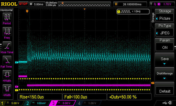

The scope is triggered by the falling edge of the L-ON signal, so everything is related to that edge. The ‘T’ under the ‘STOP’ on the scope is where it was triggered.
I would have thought there would be some sort of synchronization, but appears that’s not the case.

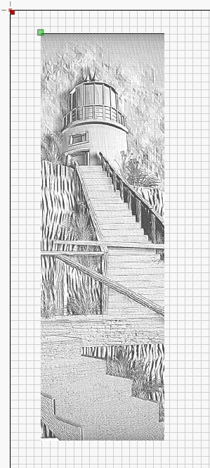

The first screenshot was not a gray scale. Here was the test image I was using in the first post.

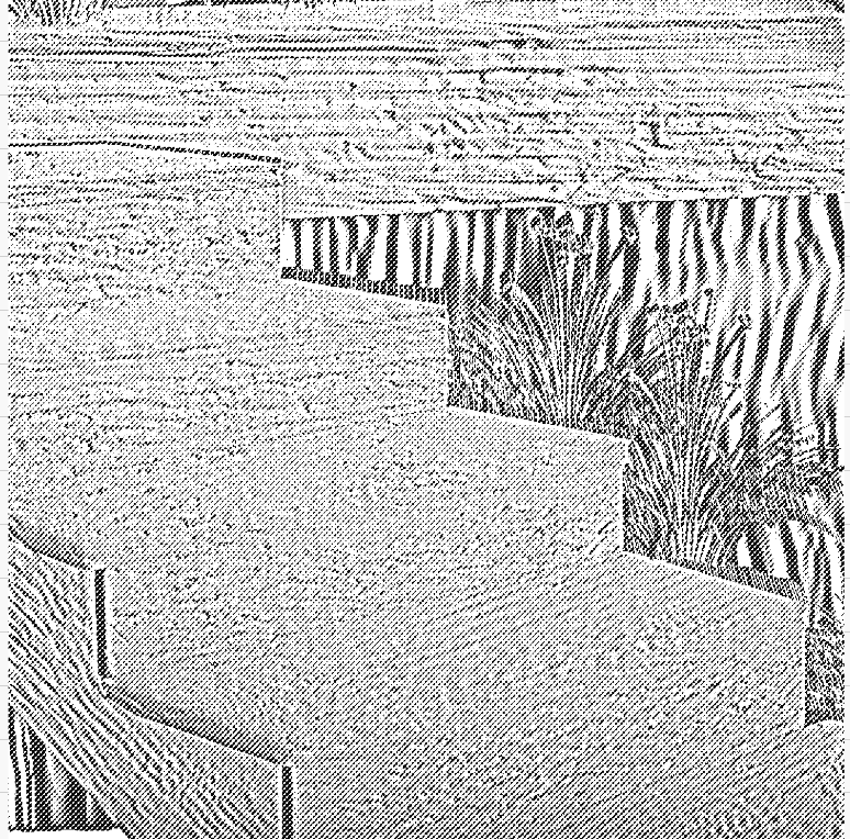

‘Zoomed’ in the pattern is more clear.

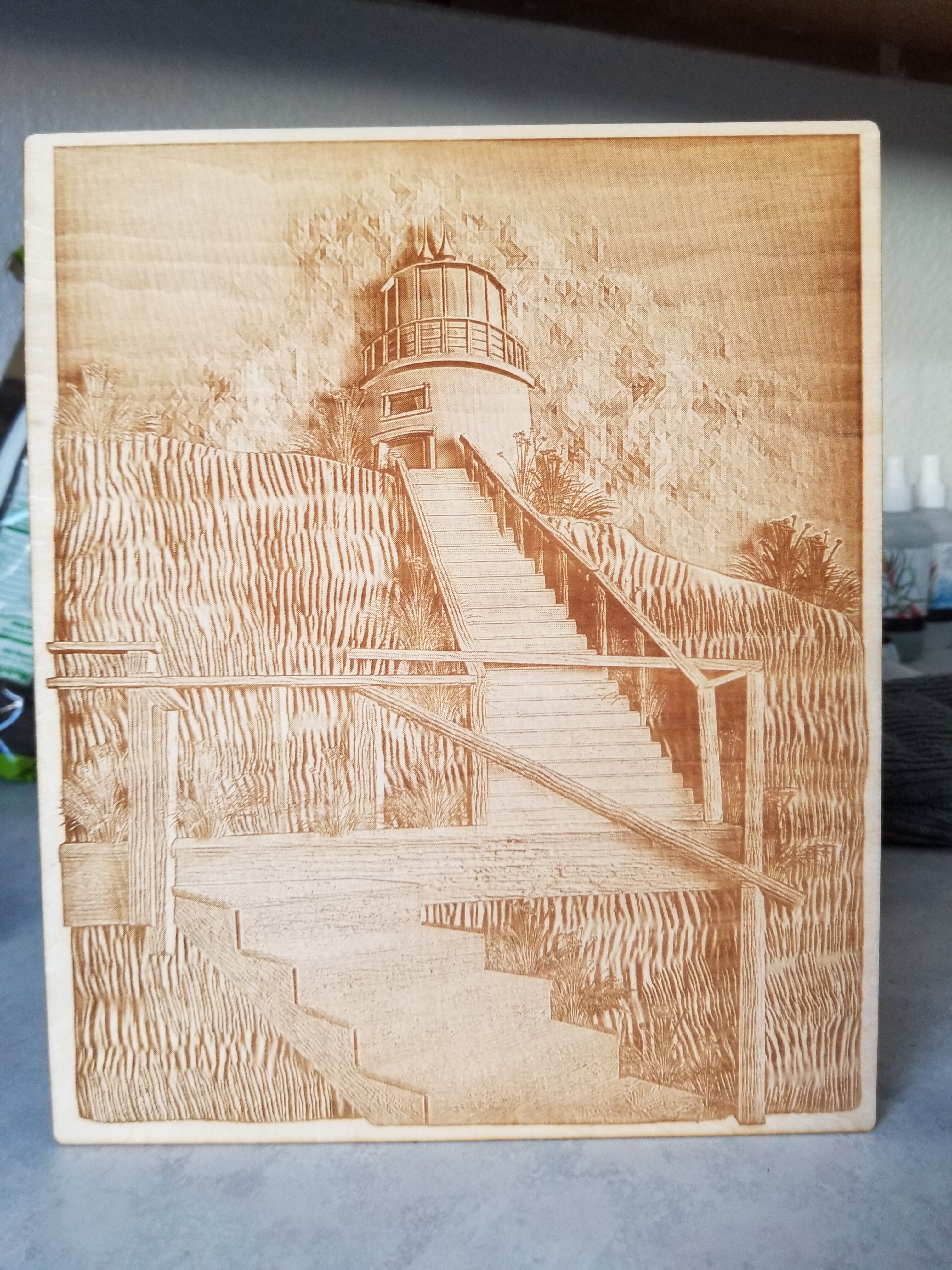

However it must be working here is a 60 minute run of the finished item.

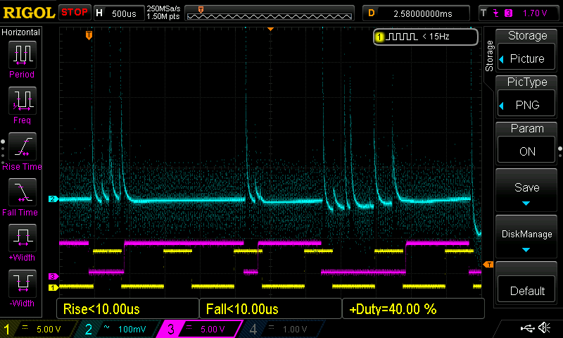

To simplify what was happening, I drew a line and set it to 300mm/s@50%… I’ve kept the period of the pwm to the slower 1mS.
This one is 100mm/s@50%… just to see if there is any difference. The scope horizontal scan rate is increased to 200uS.
This has the horizontal sweep to 5mS/div…
I was scrutinizing this area of the first image in this post.
DS1Z_QuickPrint3
A ‘negative resistance’ device …?
Not clear what’s going on… Any ideas?
