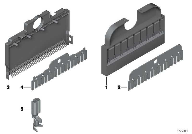

Go to a BMW dealer and ask for part#
6113 1 387 150
They come in many pin count variations and there are even housings
