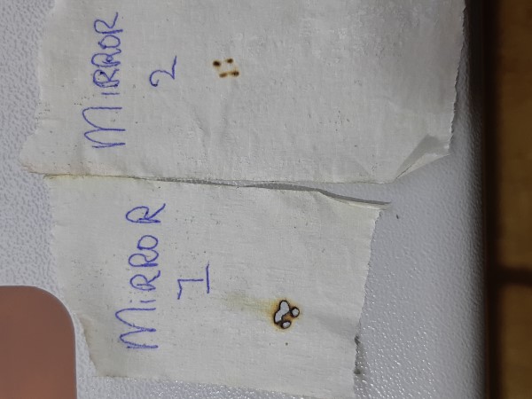

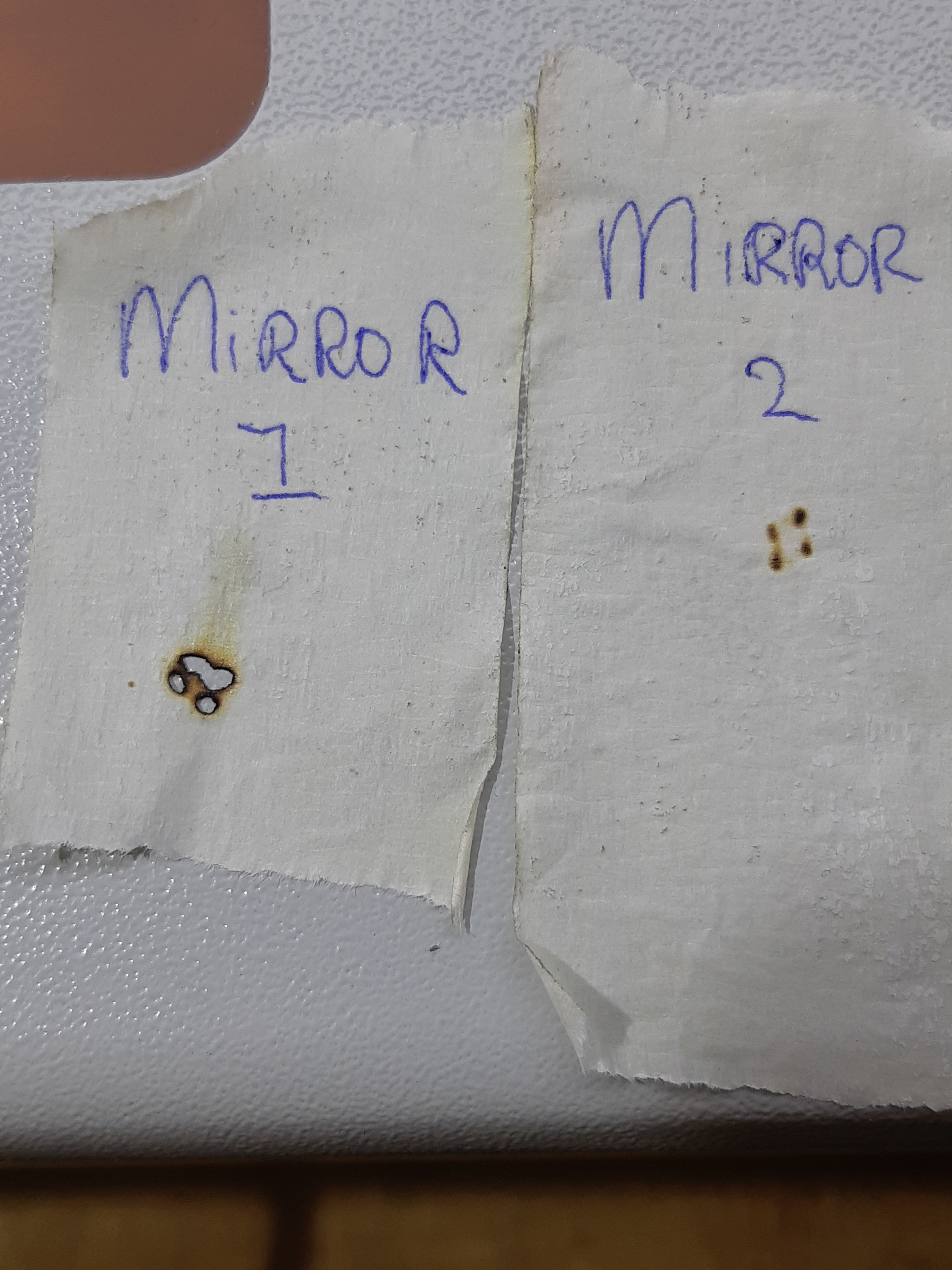

After that i thought that it would be a good idea to check the mirrors.
The picture shows it:
mirror
No beam!
How can i line up the laser?
How could this happen and how can a prevent it?
is the power supply the problem?
Groeten Ben

My pattern looks like this:
Could it be a power supply problem?
Greetings Ben

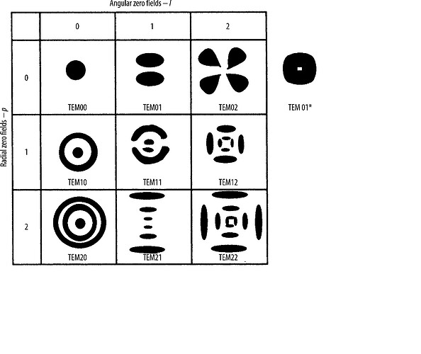

Are those patterns from a test fire of a single test fire? If so, then your tube has shifted mode and there is nothing you can do but get a new tube. The references HalfNormal posted about talk about laser (TEM) modes, but I see the link for the first one is now dead.
Why this happened is hard to say. Mostly likely either your tube has leaked gas or something changed / failed with the optical ends of the tube.
The laser tube can degrade very quickliy when it get too hot. You should also check your water cooling.
it was just 1 test fire.
