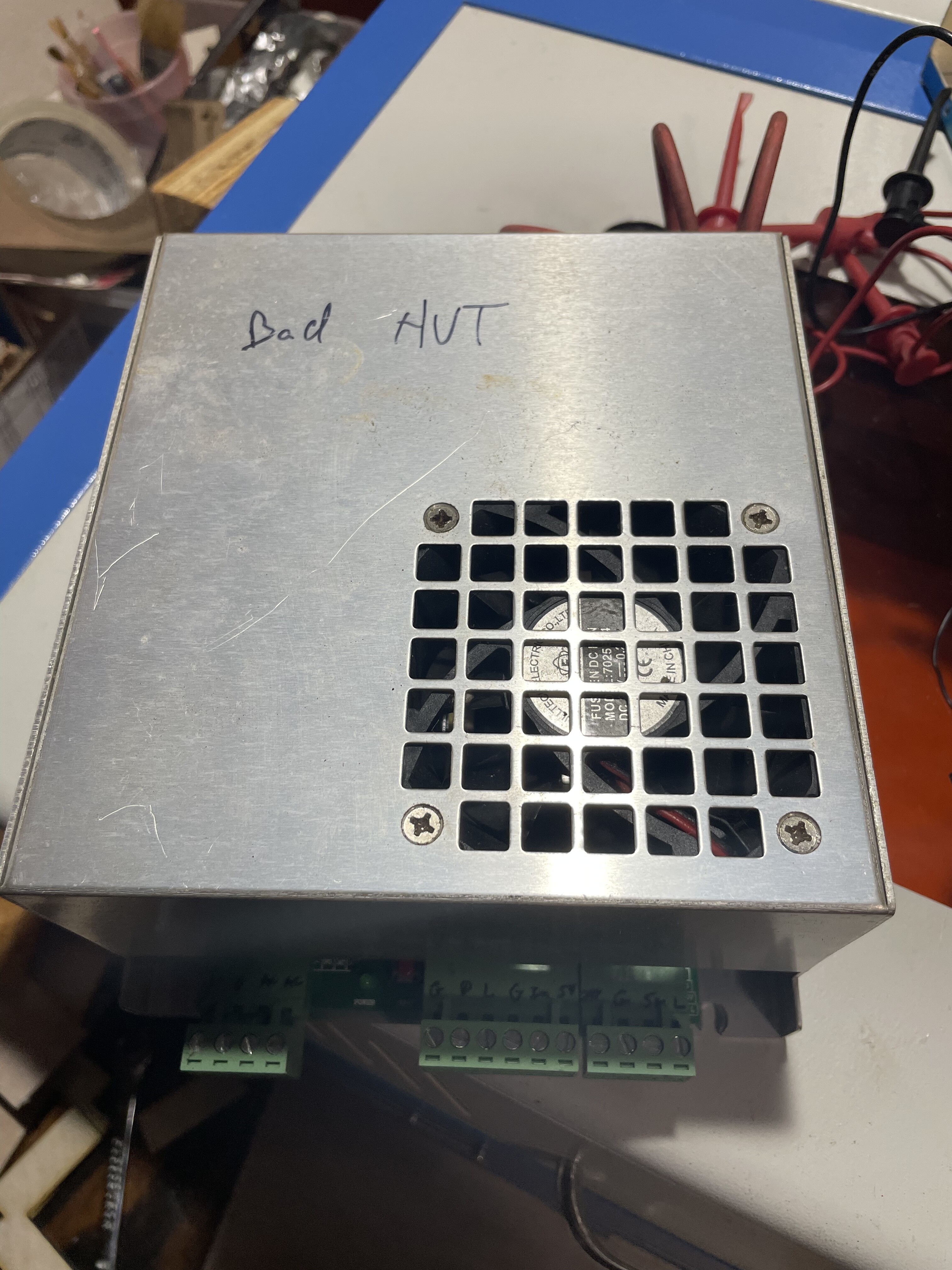

That’s an old vintage supply.
In any case, I doubt you can find a replacement diode by Monday when your new supply comes?
Well, I do still have the stock LPS I replaced a couple of years ago. :grin:
May be good for parts?
Do you know that the old one only has a bad HVT???
You could swap the new HVT with the old one.
If they have the same HVT.

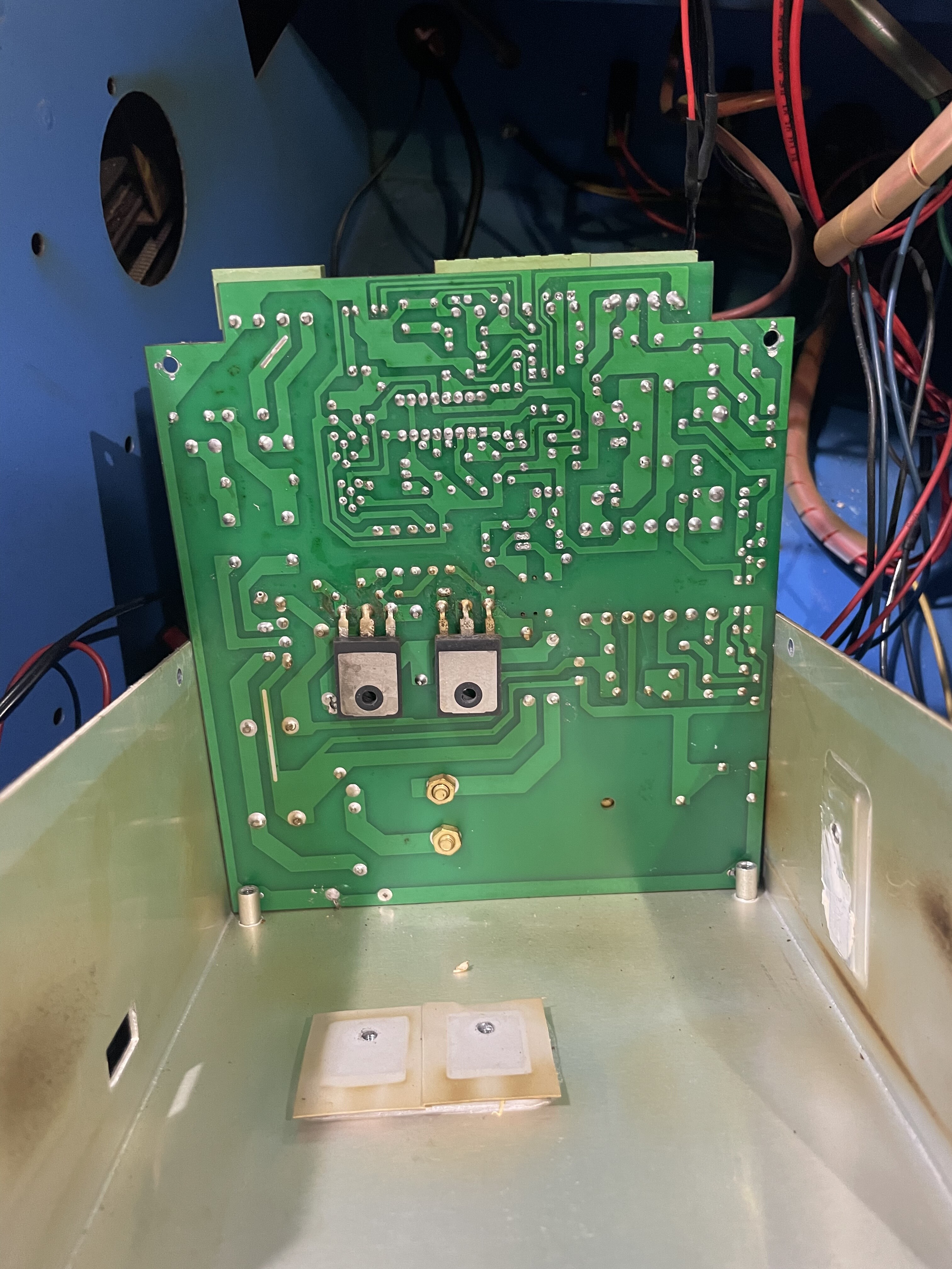

The challenge with these supplies is that when the HV driver side goes it usually takes lots of components with it that is why I stopped repairing them.
Pull the PCB off the frame (on the most recent one) and see if there are any burned parts on the other side. Those FETs are the drivers.
Here you go. Looks good to me.

Nothing obvious.
Are the two hvt’s the same?
No markings on the HVT for the newer supply. The way they connect are very different.

Pictures of the two different HVT’s?
The HVT’s have various mounting options.
