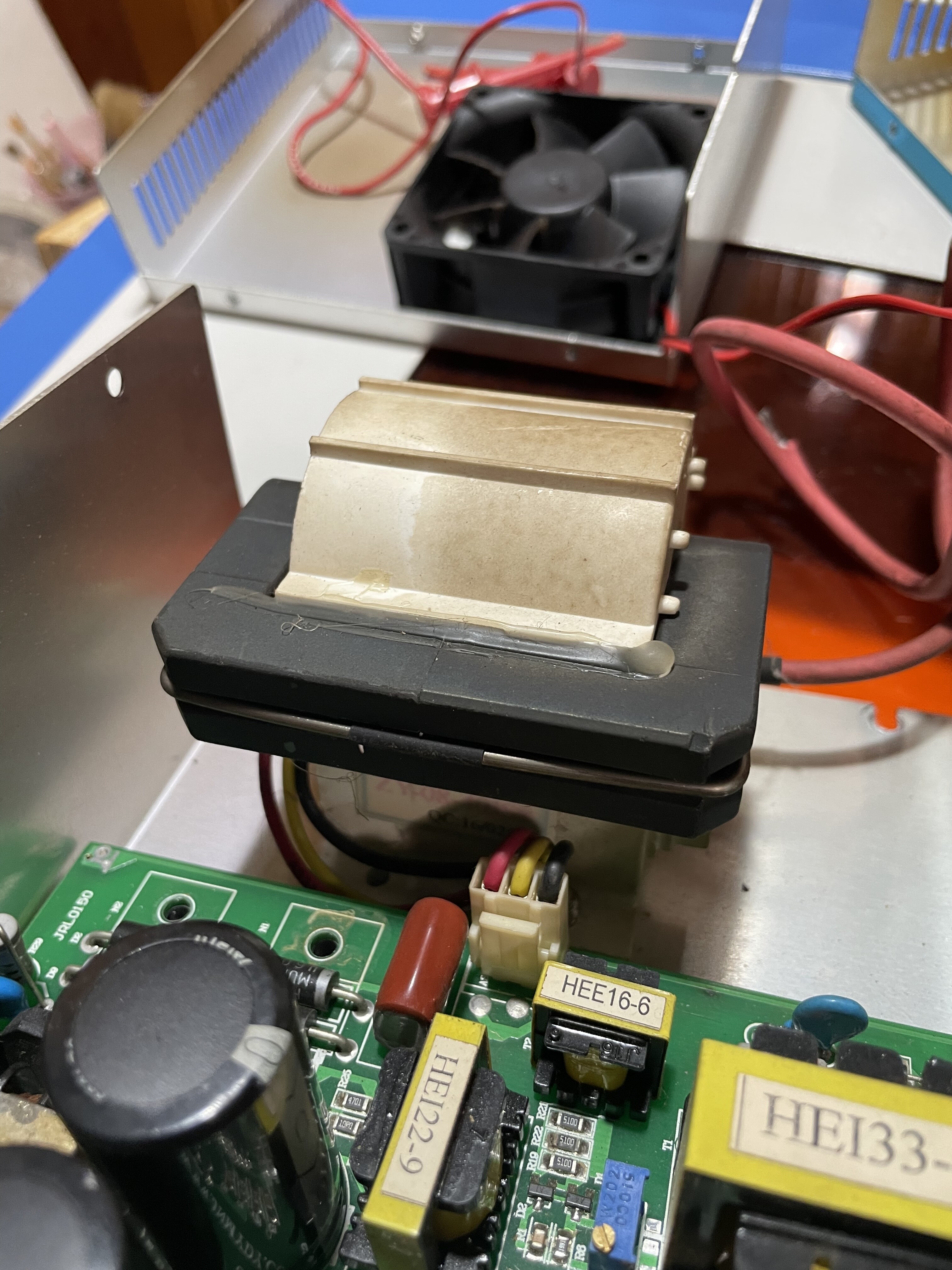

Interesting, I know the 5v is 1 amp because it uses a 3 terminal regulator.
I thought the 24V had a higher capacity. The 24V output is simple a 1/2 wave rectifier schema and the diode is rated at 4amps although I do not know what the transformer is rated.
The LV transformer gets its input from the HV circuit using a funky offline switching device [KA5L0380R]. Many times I found that part and other parts on the front end of the LVPS transformer were blown.
In my experience, often the 5V and 24V go out at the same time suggesting the driving circuits fail.
I’ve seen a few things seem to fail on power-off or power-on lately. Last was a charger for a GEM(street legal ‘golf cart’) which was working fine, was unplugged for a quick trip and then when plugged back in DOA. Seems electronics get stressed mostly in those scenarios once aging sets in.
The new one is bolted to the PCB from the bottom?

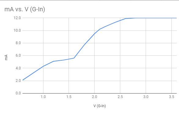

I have a new problem now. Of course. I was trying to characterize the new supply pot V (G-In) vs mA. Got a crazy chart and it plateaus out at 12mA. :sob:
May just say F-it and put the old supply back in. Got it unplugged right now to give it some time to discharge before I touch things.
Putting in the old supply would be worthwhile to see if it still plateaus.
Besides the supply, it could be the tube. Have you been able to run the tube above 12ma prior to the LPS problem?
At above 2.5V is anything arcing or hissing?

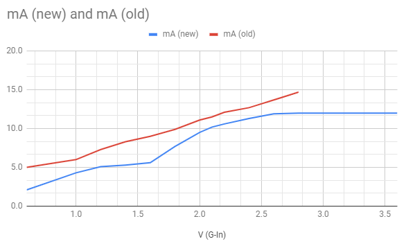

Note that this curve is much weaker than the one you plotted new.
Sorry @NedMan, almost done with everything… should have to keep unplugging everything lol.
Yeah it could definitely be the tube. Have seen some loss of power. Didn’t notice any arcing or hissing above 2.5V.
Here is old reinstalled LPS vs New.
Crappy supply it looks like.
When old LPS was new (green) vs now (orange)
