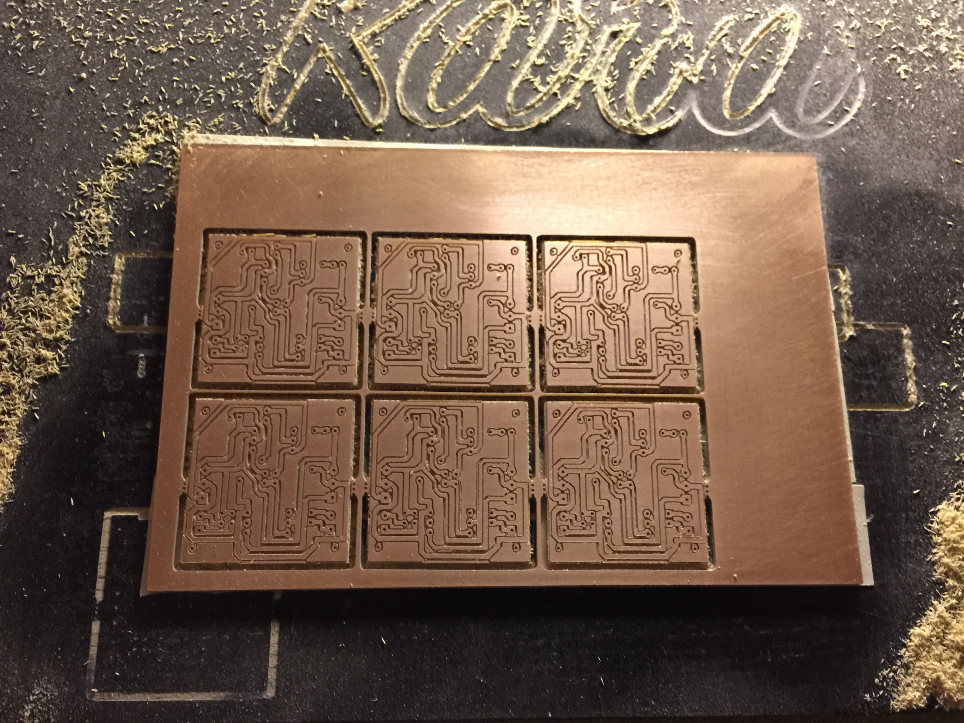

Pre-spindle upgrade.
Dremel 4200
Eagle > PCB-GCODE > OctoPrint.
3 ops. Etch, Drill and mill.
It’s not perfect. But all the boards work.
Dremel 4200
Did you do any auto-levelling of the PCB to make sure you got no air traces in low spots of the board? Did PCB-Gcode generate those tabs with the 3 holes drilled in each tab (I don’t recall PCB-Gcode having a tab feature)? How low in the Z did you go to mill the traces?
No auto-leveling. All the lower traces came out okay. Not perfect but useable. The milling and the drill taps I made manually in Eagle. I used a 20 Degree 0.1 bit and the Z Down was set to -0.1025
Nice work. I’m amazed all those traces came out ok without auto-levelling. You must’ve had a pretty non-warped board. I find with auto-levelling that PCB blanks can be 0.3mm off in some spots. I found running an hour long PCB job and then having air traces killed me.
Thanks! I have not added the necessary components for auto-leveling. I am going to wait till the machine gets to it’s final size and the control box is completed. But I am pretty stoked about not having to use photoresist any more.
