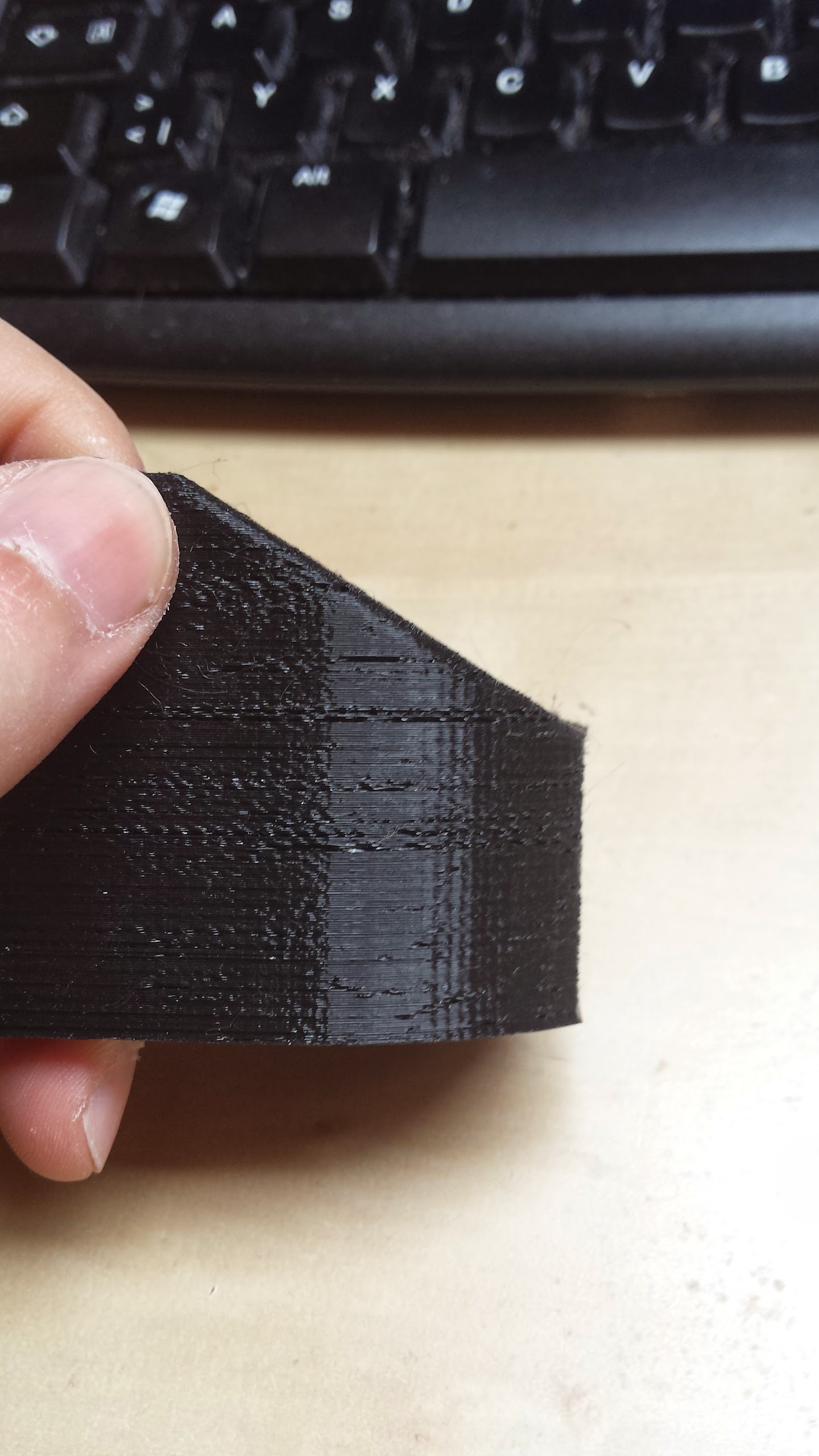

Print quality went up a lot since I fixed that thermistor dislocation problem which
Print quality went up a lot since I fixed that thermistor dislocation problem which cased way too high printing temperature. Still there are some things that I can optimize, I guess.
I this 0.1mm layer height? If yes try 0.2 or even 0.3. For first prints and calibration it’s better to use thick layers. You can go down to the limits of your machine if you control the default process.
Your retract seams to be not correct and you should maybe increase cooling.
It’s actually 0.2mm. Retract settings are a little bit extreme, I guess. They are set to 8mm retract, 1.2mm z-lift, 80mm/s retract speed and wiping is on. I’ve made these settings because the printer was heavily drooling due to a way too high printing temperature. I’ll reset them to default and see what that will bring about.
