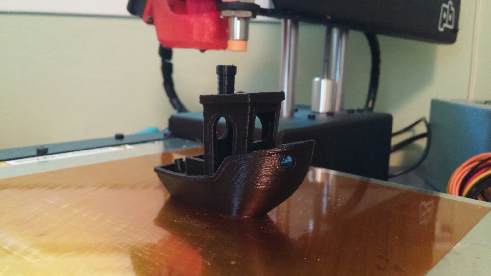

Printed 3DBenchy  with the all metal Ubis 13 on my Printrbot  Simple Metal with
Printed @3DBenchy with the all metal Ubis 13 on my @Printrbot Simple Metal with Heated Bed. White is old ceramix hotend, black is the new Ubis 13. Retraction is 4mm and 0.4mm for the white and black respectively. Overhangs and fine details print so much better with the new hotend. The slight rippling on the black is micro and is just the way the light catches the object. Unfortunately Octoprint screwed up the timelapse render. See below for settings
Scale: 1:1
Layer height: 0.2 mm
Infill: 10%
Print speed : 30 mm/s
Print nozzle diameter: 0.4 mm
White one has 100% infill because I forgot to change the settings.
Black is almost invisible. :wink:
It was what was loaded. My white was in storage sorry

Pretty much the same settings as the original ceramic except retraction has to be kept between 0.3 and 0.5 mm. What happens when you use Cura?

BEAUTIFUL! What are the big differences between this and the default?

@Adam_Steinmark What fan shroud are you using with the all metal hot end? I can’t seem to find one that fits. They all hit the fan on the hot end
@David_Worth1 It doesn’t fit actually. You can’t really tell by the pictures but the fan mount for the hotend is actually turned a bit and the fan shroud for the original fan is slightly crushed. I’m currently using the latest version of http://www.thingiverse.com/thing:356001 . I can’t seem to be able to modify the Solidworks files to fit better so I’m gonna make my own hopefully by the end of the week. But hey it fits if you force it.
