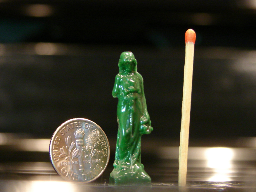

Printed a copy of the cemetery statue from Thingiverse at http://www.thingiverse.com/thing:26317 printed using a 0.10 mm http://www.jerrill.com nozzle on a Printrbot PLUS. And yes, you can balance a matchstick on it’s end with the help of some tape.

That looks great, what material and layer thickness was it printed with?
ABS, 0.08 mm layer thickness, 0.10 mm custom nozzle, about 2 and half hours to print, finished with a few seconds in acetone steam for surface finish.
Very nice! Great detail for something that small. What was the scaling factor of the original STL ~35%?

@Michael_Audette 35% is correct!
