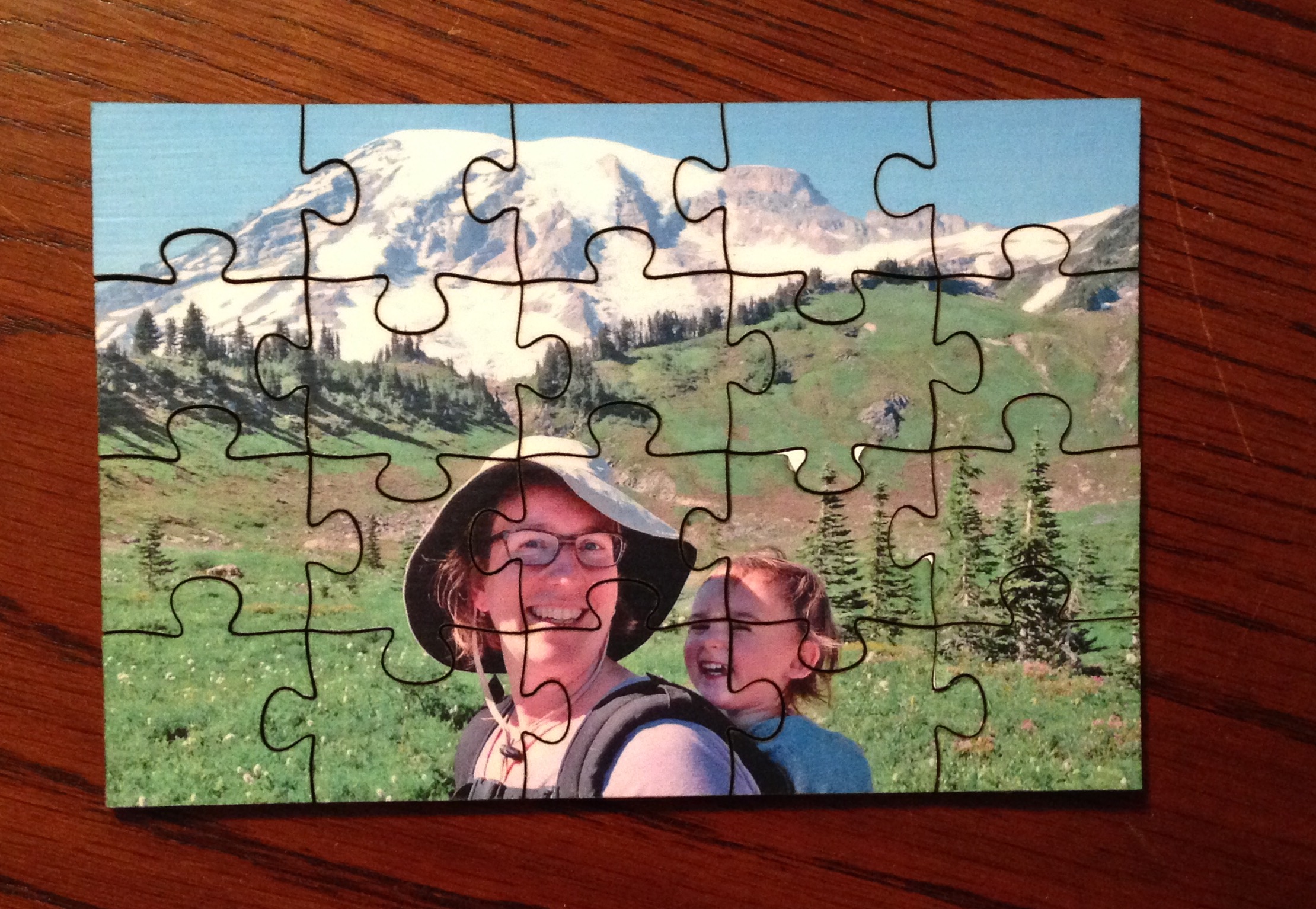

Printed a photo on my laser printer,
Printed a photo on my laser printer, decoupage’d it to 3mm plywood with Mod Podge, then cut it with a puzzle pattern, 2 passes at 20mm/sec ~10mA to try to minimize burning… except somehow I forgot to switch on air assist, so there was some flame!
I had protective tape on it, though, so not much damage to the image. The image did peel up a little in a couple places (shown here), so I Mod Podge’d em back down, not sure how durable it will be.
Durability test will be: give it to my 2-year-old, who loves puzzles.
Nice work. Seems to have come out pretty well with minimal charring on the edges.

That looks really great! What if you cut from the other side? Make the first pass kind of heavy, then when you are about to cut through, lower the power so you dont char the paper.
It actually didn’t char too badly cutting from the front, despite my somehow forgetting to turn on air assist (first time for everything, I guess!)
I also need to align my mirrors, something I’ve been putting off since I got the K40, I noticed the cut is not as deep in the lower right.
@Tev_Kaber It turned out nice. The cut being not as deep on the lower right could be alignment, but could also be the distance between the head & the cutting area is not level in that corner.
Oh good point, I should make sure my bed is level. I just have 4 long screws with leveling nuts holding up a honeycomb.
@Tev_Kaber Hopefully it is just slightly out of level in comparison to the carriage movement. Would be much easier to adjust than an entire alignment.
