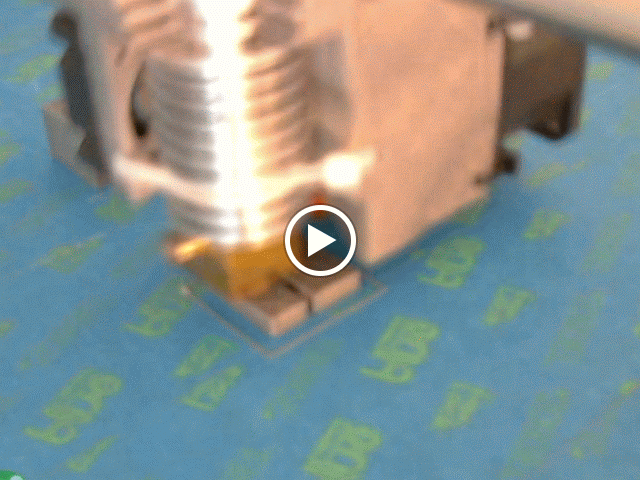

Printed a whole set of new XY ends for another #Eustathios . Need to get a higher quality webcam ![]()
I don’t even use those extra little blocks myself. I use the 3-ziptie method. Using those 2 little blocks puts strain on the plastic, which is likely to warp and/or break in the sun or under tension. If you tension the belt against itself, and then merely use the attachment to drive the block, the block will last longer.
If its a Logitech c270 you can pop off the cover and adjust the focal ring for close up focus. There is a good writeup on this if you Google for it.
@Eclsnowman Thanks for the tip. I can’t figure out why logitech glues the focus ring in place which is adjusted for such a long focal length by default. Much clearer videos are on their way!
