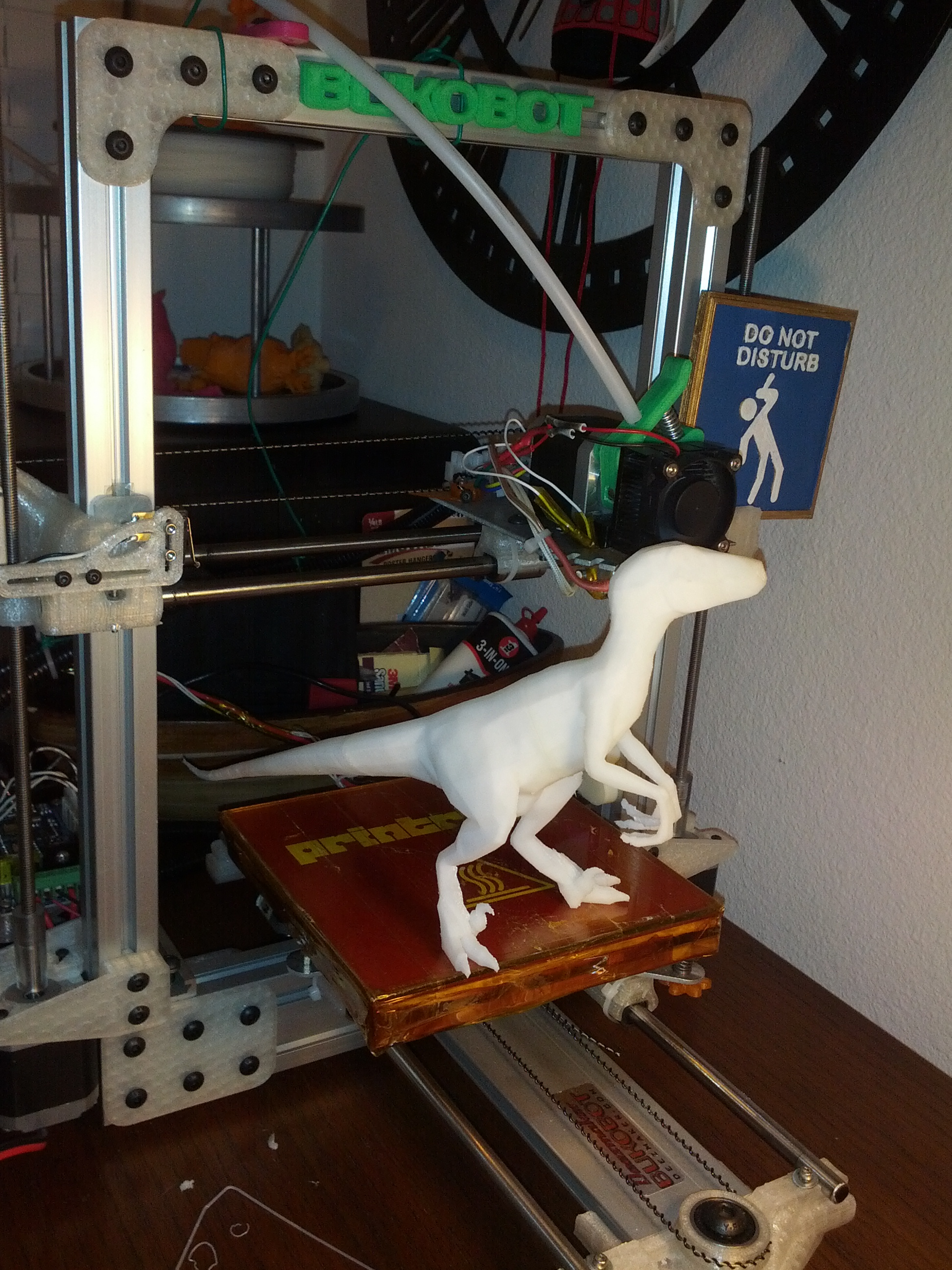

Printed my buddy’s raptor model by splicing it into three parts + a hat. Printed at .2mm on a bukobot mini 1.75mm mod.
Great print! What slicer and support settings did you use?
I used Slic3r, with standard support turned on except changed the default separation to 1 mm instead of 2.5 default. One talon didnt make it but otherwise, the print came out great
