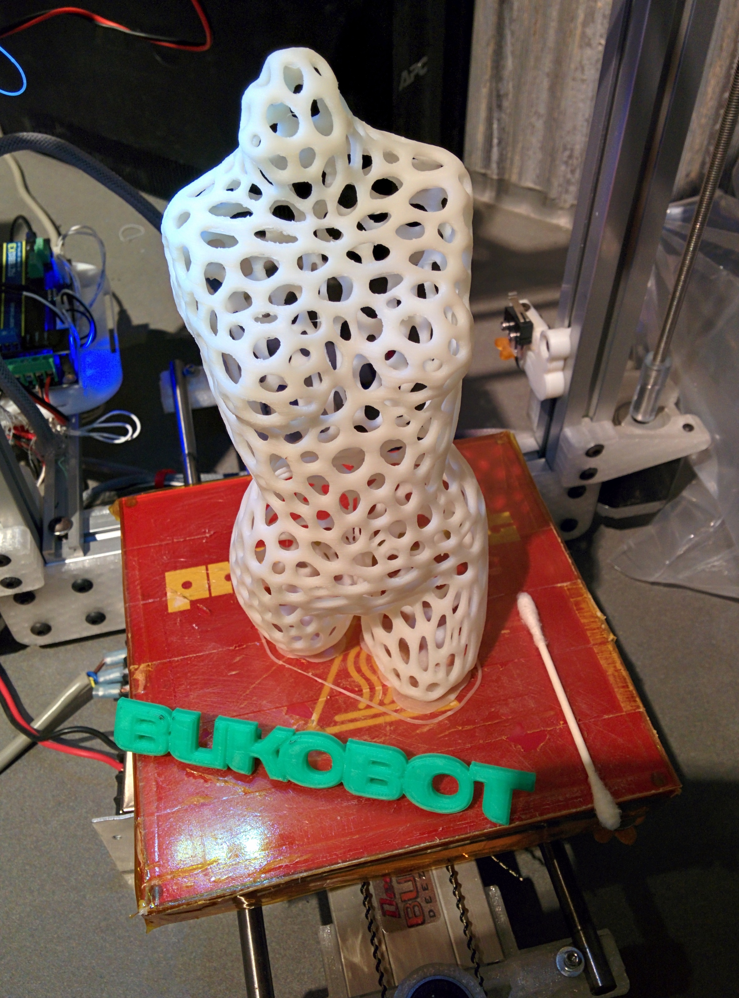

Printed on my Bukobot 1.75 extruder mod.
Printed on my Bukobot 1.75 extruder mod. Took a little over 10 hours at .15 layer height in Prototype Supply Natural ABS. I sliced the first 6 layers off the model to give it more of a base to deter curling. Almost maxed out my build height at 180mm.
