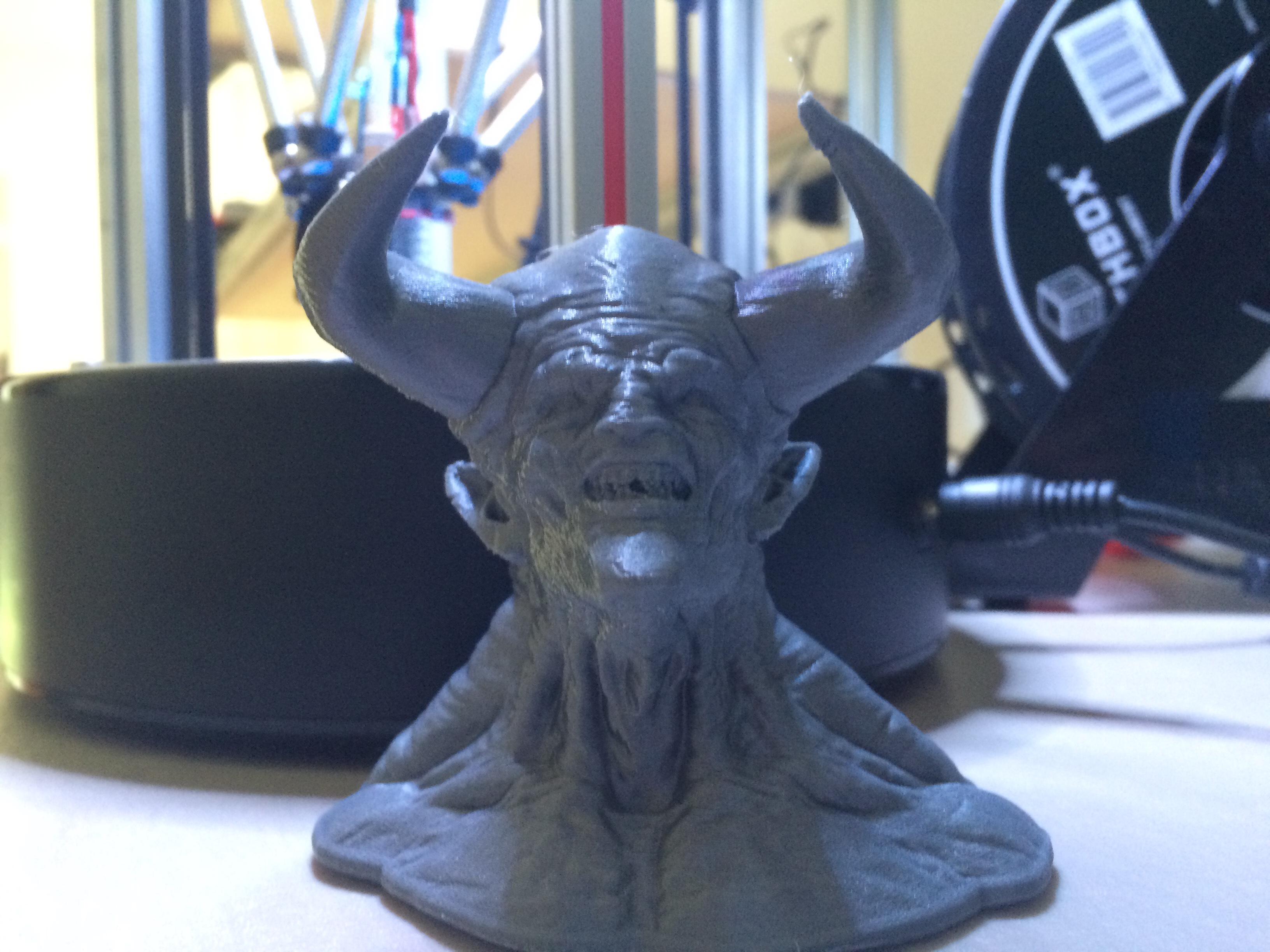

Printed on the Delta Go at 0.15mm layer height. About 10 hrs.
Printed on the Delta Go at 0.15mm layer height. About 10 hrs. No cooling fan for print. 213 Celsius silver PLA.
It’s hideous.
But the print quality seems good.
Hideously beautiful
many details
still hideous
Nice Print. Printing @ 213 deg C with PLA seems pretty high. I haven’t had to print PLA above 195 deg C. What brand PLA are you using?
Was using Hatchbox for this print, but we mainly use eSun now. Reason for high temp was so that we can print fast. Our Delta Go is designed for speed and the new Mini-Hotend contains the heat very well.
