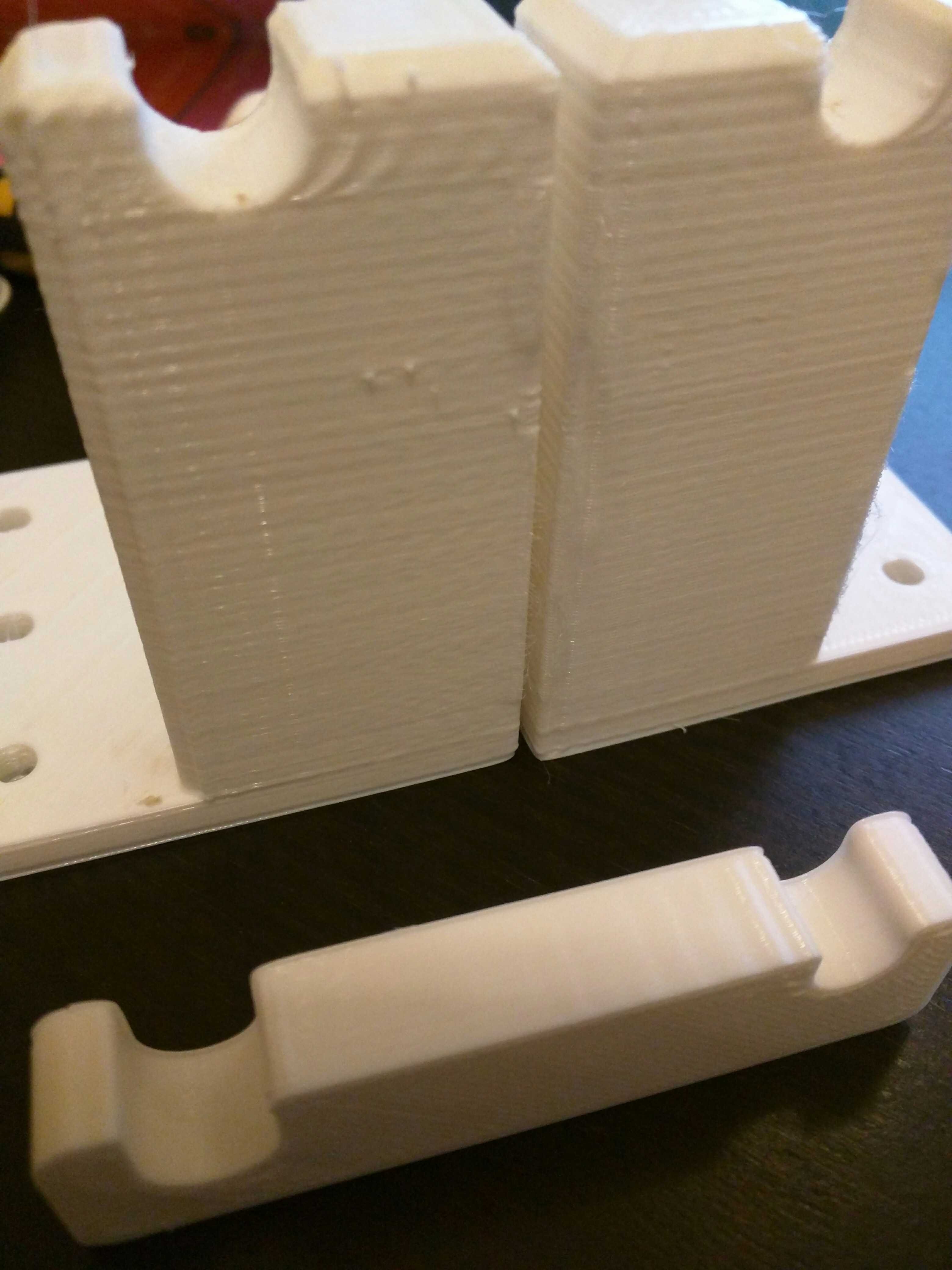

Printed one of the rod alignment tool that @Eclsnowman posted to realize I need to print another
Also I am getting these ringing effects on the vertical surface of my print. What is the cause of this?

Slow your non-printed moves brother. Are you on the simple?
Yes. I am on the simple metal.
My speed is only 40. Hardly fast.
Also, just an FYI these don’t work for HercuLien. The corner brackets set the distance by themselves. But the downside is on HercuLien if you don’t have accurate prints you could bind since there are no degrees of freedom. But mine worked right after assembly smooth as butter, so it is a better method IMHO than trying to align 8 rod ends independently.
@Dat_Chu what are your jerk settings at?
My firmware has the acceleration set to 1500. Retraction acceleration 3000. Is that the one? @SirGeekALot . Thanks for the info @Eclsnowman . I assume there is a way to improve print measurement accuracy?

I see. When I use octopi I can’t seem to get the values out since the app will keep on scrolling. I will update this post later. So what values should we put in m205?
In octopi, if you turn off autoscroll then it’s much easier to scroll back and see the output of M503.
If you want to print fast, but avoid exterior ringing, print inside infill and perimeters first at high speed, then just slow down the outside perimeters.
I think cura slices it with the inner perimeter then outer perimeter then the infill. What do you use to control these settings? Repetier.
Simplify3d
The shadows of the circular feature I call ringing. It’s basically mechanical oscillations that occur when the head changes directions. You generally need to slow down the outer perimiters to get rid of these. If you can modify the design to have rounded edges, then this artifact will be minimized.
The horizontal lines are causes by somehing in the z-axis. The exact cause will depend on the design of your printer. If you have z-steppers on top with hanging couplers, then the spring in the couplers is the cause. You either need a thrust bearing or something at he bottom for the leadscrews to rest on so that they don’t bounce up and down.
If you have the couplers at the bottom, make sure that the leadscrew and the stepper shaft are touching inside the coupler.
