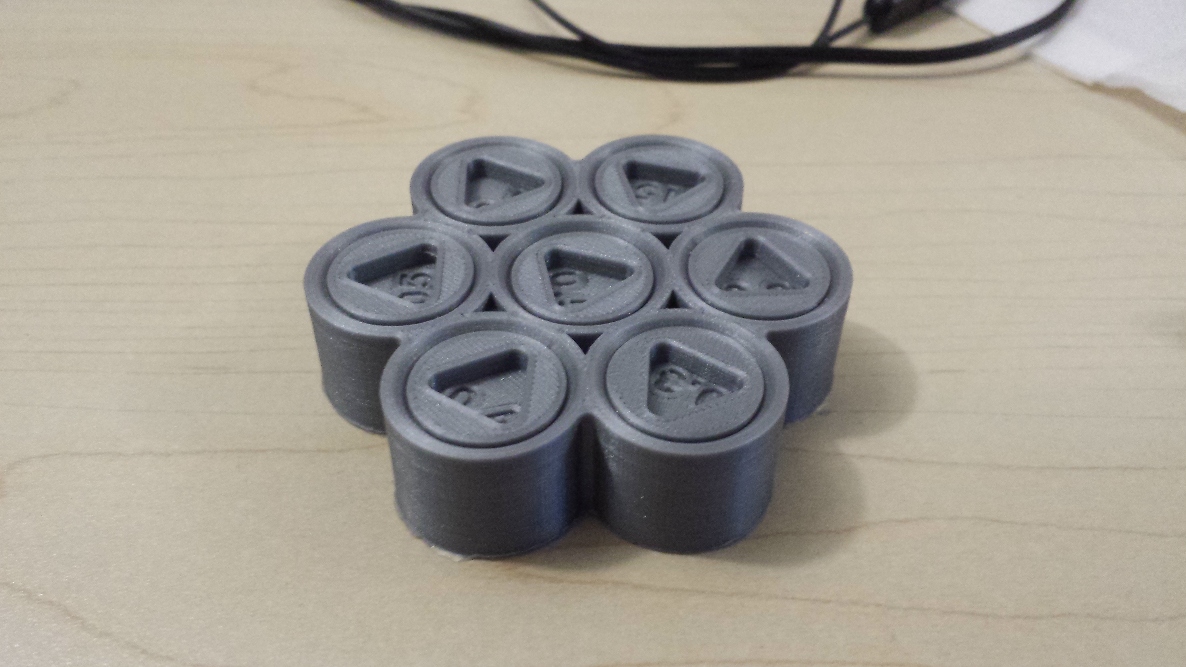

Printed the Maker’s Muse tolerence test with a 0.2 nozzle with 0.08 mm layers. The 0.05 would not slice as a seperate part. All others printed fine and move freely, only the 0.1 is too fused to work free. ^^
Do those inner cylinders revolve?
All revolve properly except the 0.1 gap. And the 0.05 was considered part of the mount by the slicer. @Todd_Frederiksen
