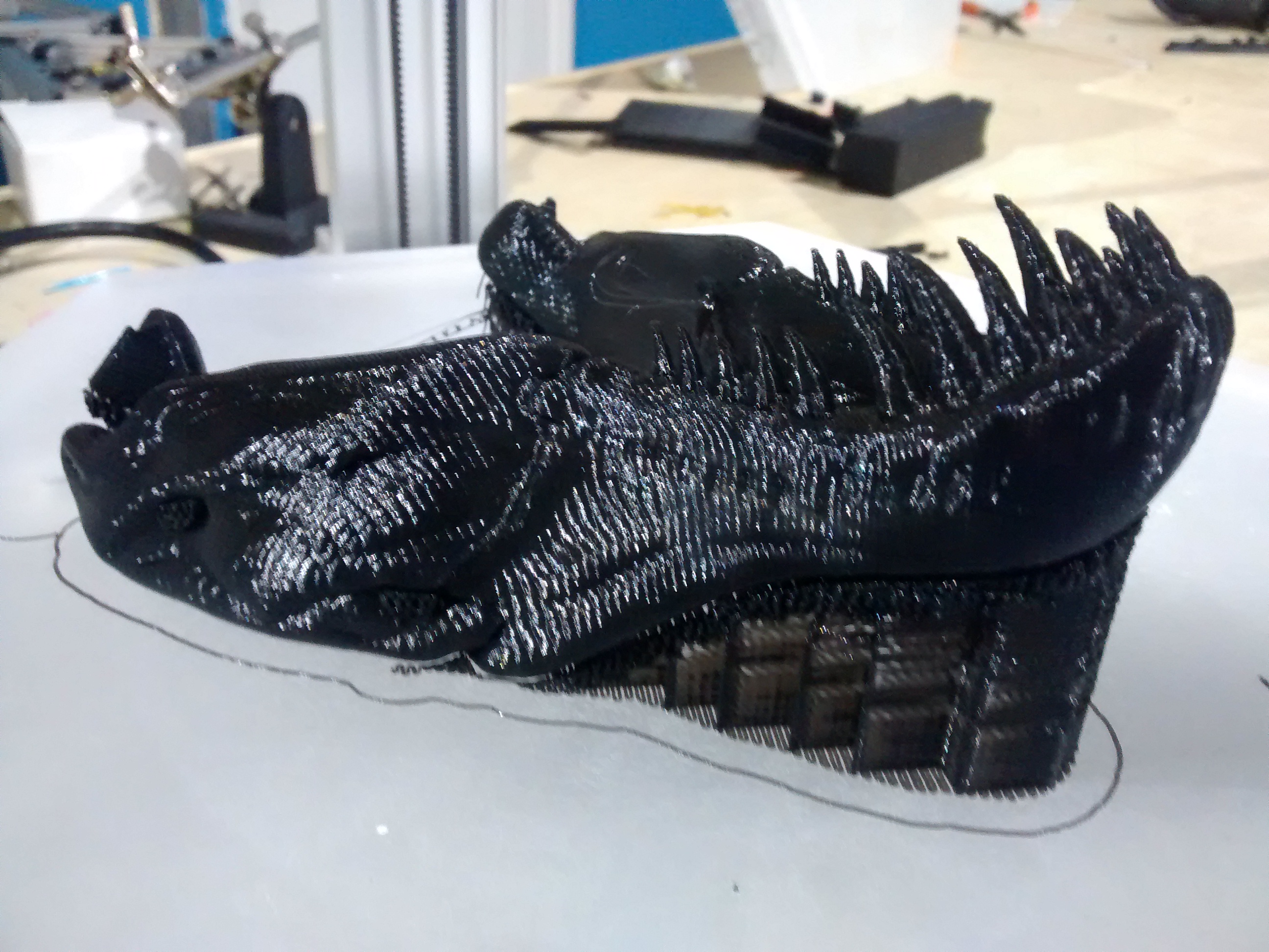

Printed the T-Rex skull from Thingiverse. KISSlicer generated support came off so perfectly. One of my best prints to date. I’ve never been so impressed with PLA-on-PLA support.
Well now I wa;a try kiss again!
@Kevin_Conner , I know the picture of the top part of the skull doesn’t show very well, but the whole cavity was filled with support material because we were doing such a large layer height. I pushed it out with a flathead screwdriver with ease. Normally support structure (for me) ends up with me stabbing myself under the fingernails with PLA barbs…

What setting did you have this on? Options like ‘Coarse’ and ‘Ultra’ was always a little confusing to me, I just wanna know which one will be easiest to remove!
Coarse support. I also increased the horizontal gap to 0.8mm. As the part gets closer to needing support material, it’ll make it more dense to support the exterior of the part.
What you’re selecting is the density of support material. “Ultra” is Ultra-dense. Coarse is not very dense at all.
