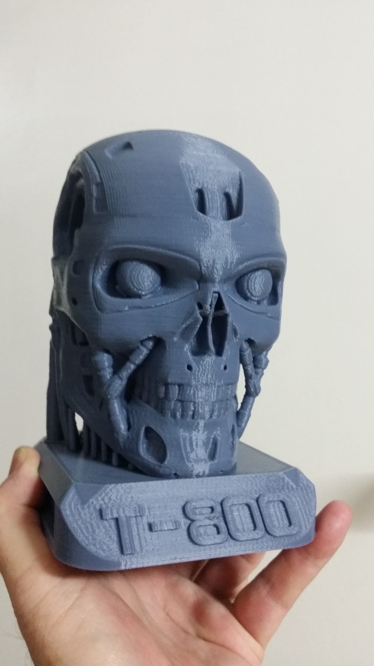

Printed the T800 & printing time was 6 Hours at layer height of 0.2000.
Printed the T800 & printing time was 6 Hours at layer height of 0.2000. Esun PLA . Wonder what colour to spray the #T800 to give it the finished look. #3Dprint #3Dprinting #Robobeast
Shiny silver.
spray it with a conductive paint, then get it chromed or plated. Be sure to use a good filler primer to remove the layer lines, for best effect.
First: sprayground (right part) https://photos.google.com/share/AF1QipNpc3p8qY-0LYYL51qAqJwvXTTY2gDO4mbfh15ofXt1tL2c7uhzcPMxGy-4yZMkhQ?key=LWExNTdBUmV0ZWYyZ0pCRzhucmh5elJBRFZkczJn
Second: stainless steel effect spray and clear lack spray https://photos.google.com/share/AF1QipNlZg1iV2YO7TzsoIqdVRsy2UTKfNofLx_GAo8KSZzZmref2MK3LANcXVoTUVn4QA?key=VzY2WGFPZWtjTkJyMDFJWWpFV2x4cHliRUZOaGhB
Finally, You can use the spray paint of your choice (for example, for Terminator would Gunmetal spray) for the last layer, and take the used / damaged look with a piece of cotton wool and acetone (wipe partially a uppermost layer ) https://photos.google.com/share/AF1QipP1qb-wDb6psdqI2nSZa4Fe7CG4wU290bEjnA83c21P-cBFhJEDyMRWroz1S6XQzw?key=Qmc4cFFJV3Fxei15OE9mUElMRzk0QWVnZW5mVVZn
@Maxim_Melcher When you looking for paint filler, does it say filler on the can. I never seen a filler paint. The idea of having it Chromed, never thought you can Chrome plastic.Some fantastic advice guys , thanks. I might even print another one & try the Gun metal finish as well.
The stainless steel with clear is beautiful, wow did not realise it can come out so well on plastic. Pla . Thanks guys
