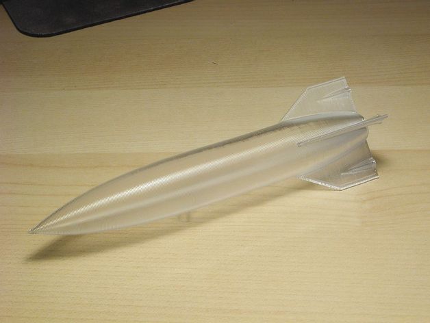

Printed this 1100mm tall rocket.
Printed this 1100mm tall rocket. Printed in PLA with 0.6mm nozzle and 0.4mm layer in vasemode.Print took 6 hours.
This is very cool
What is your movement speed setting? 3200 mm/min? above?
@Troels_Askholm
X / Y movement 8400mm / min (140mm / s), Default printing speed 4500mm / min (75mm / s). Printed at 300% on this print.
